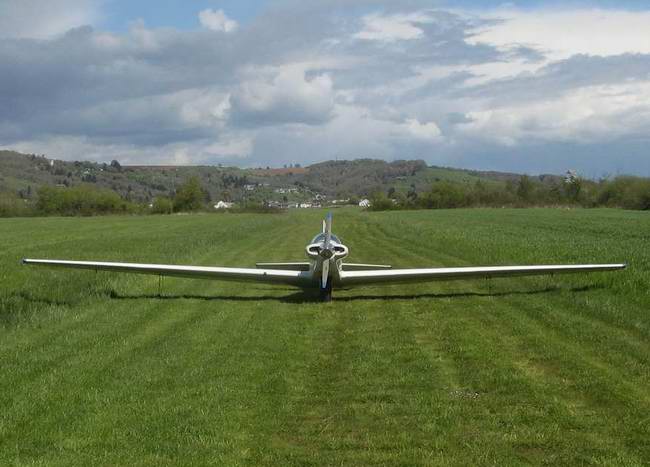

Hmm, perhaps not since I finally hang up my full scale spurs and set my trusted old Fournier free to roam greener pastures up in Oregon about four years ago.
