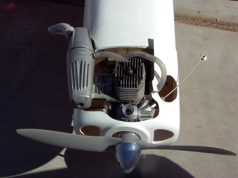

Two of our locals are now flying Senior Cadets with the OS 15GT and it proving to be a fine combination. I have one Cadet that I call the Catalina Cadet it is a float plane set up for cross country flights that carries one gallon of fuel. Its original engine was the OS 95Ax and later I downsized to a OS .65AX both two strokes but based upon the performance of those two OS 15cc gassers the fellows are using I now have one also to but the installation has not been done yet.
My working Senior Cadet that I use primarily for primary training I use an OS .35AX two stroke, yes less than recommended size but if anyone ever tells you that is too small then they are just ignorant of the combo and blowing wind. That is with either the kit version or the Sig Arf versions. The Nitro Planes clones are far to heavy being typically four pounds heavier that the Sig kit or ARf.

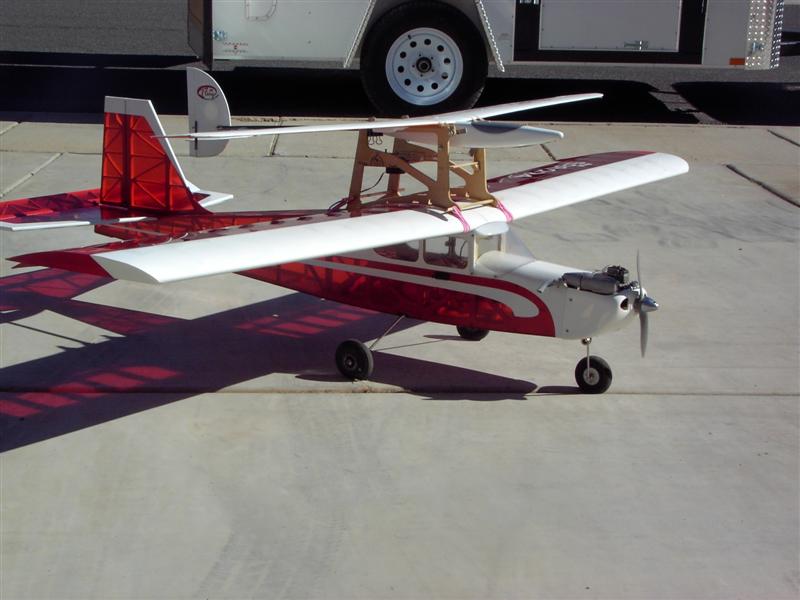

I did mention briefly earlier in this thread about my 'working' Senior I have four for different purposes but this one is the one I use extensively for primary training and on occasion glider piggyback launching. It is powered by the wonderful little OS .35AX, Yes smaller than the recommended displacement but and this is a big 'but' if it is a kit built version that has not been excessively 'improved' with reinforcing or is the Sig arf version the little engine is a highly desirable combination.
If your Cadet is some of the less desirable (heavy) clones I would not suggest the smaller engine. For example before we stopped recommending them the clone called the Super Seniors started coming in ready to fly three to four pounds heavier than the Sig Seniors.
My sig with the thirty five is superb as a trainer and what I start virtually all my students with, but what is a surprise is it even handles glider launching very well with the smaller gliders when we have a Piggyback/aerotow day., Its a working airplane. Depending of course what you are doing with the airplane such as my XC Cadet, there is no need at all for great gobs of power in fact for the new folks you are better off with the smaller engines.

For all the non belevers:
Standard Sig ARF, OS .35AX, Wind four to five.
Airframe weight six pounds thirteen ounces.
http://www.youtube.com/watch?v=J-ipvqIs8C8
John
