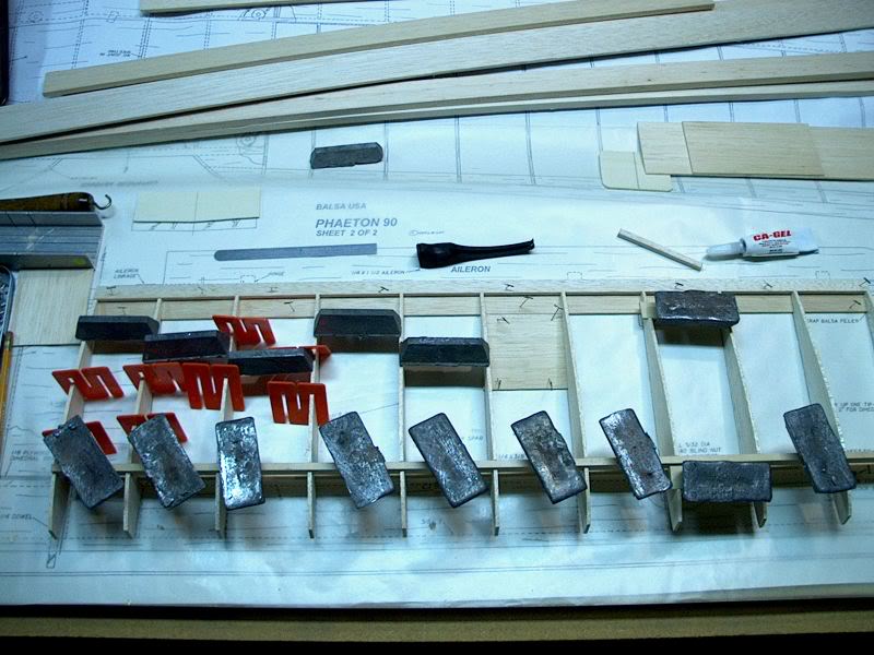

I assemble the wing dry using them and then drip CA where balsa meets balsa or spruce. It could be done one handed.
Lead weights to hoid the spars down or rubber-band "clamps"

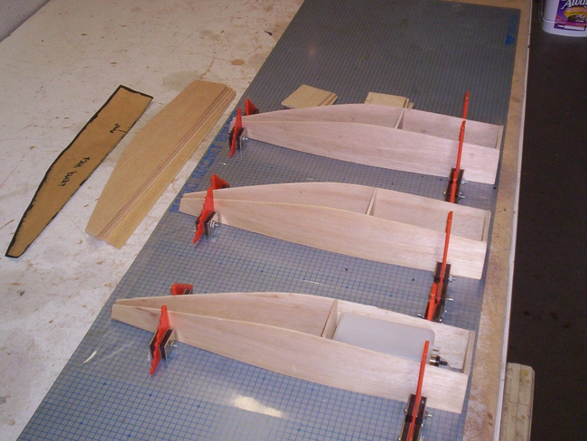

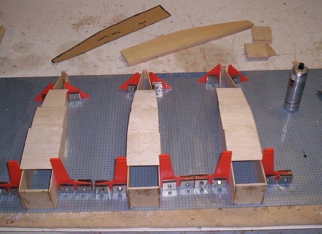

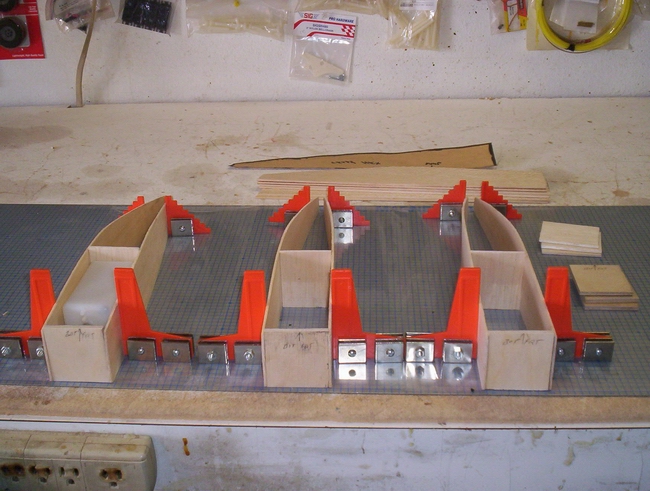

A magnetic building board is definately the way you wanna go if you are working one handed. Here is a commercial unit I have had for nearly twenty years and does get used on some builds.
John
