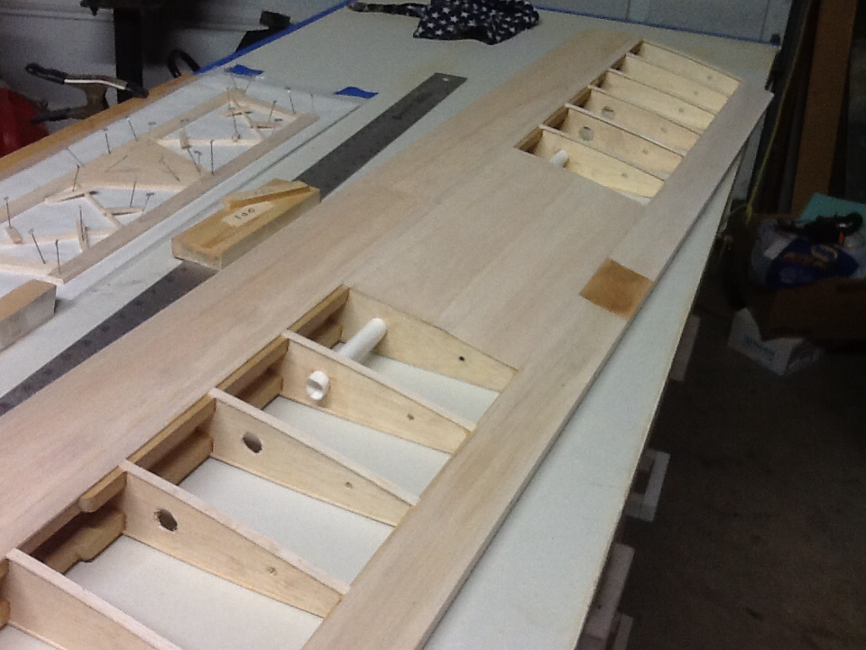

Well after about a 35 year absence I am getting back into RC airplanes. I posted about " Building in a hot shop" and it has not been a problem for me. Thought I'd share a couple of photos. Yes, a couple of opps moments. Worse was not properly securing wing flat when sheeting. I got a 5/8" wing tip difference. That took days to correct. I now have it at 3/32". I may have to leave like that. I've been to a couple of clubs and no one builds any more. It is ARF or RTF.

You can also remove some of the warp with your covering. Good Luck, DAve

Dave, that will be my last attempt for the fix. Other than this warp all seems to be going well with this build. I have learned a lot reading this forum.

It shouldn't be too difficult to eliminate the wing warp. You basically have a "D" tube wing design, except I don't see any shear webs between the spars. Shim the wing flat or with what ever amount of wash-out you want, then glue a vertical web to the back side of the spars between each rib, using 1/16" balsa. That will make the wing structure a D tube which is very resistant to further changes.

Yesterday I had to do some workshop cleaning. I rolled my building cabinet outside in the sun. The wing was shimmed, weighed and clamped. Later in the day I measured and found I was now 3/64" off. Looking better.
HighPlains, I do have sheer webs glued to front of spars. Just not visible in photo. I will take your advice and secure wing n add the rear webs. This will make it a box spar. I keep the wing weighed and clamped so maybe the last little bit will work out. Then I will keep it flat. Thanks for the tip.

Well, I am happy to report that the wing is straight arrow again. It took steam, water, windex, shimming, clamping and I believe heat from the sun and my shop. It also took a lot of time. I am keeping that wing flat until covered. Happy camper here. Now I can move on with the build.
