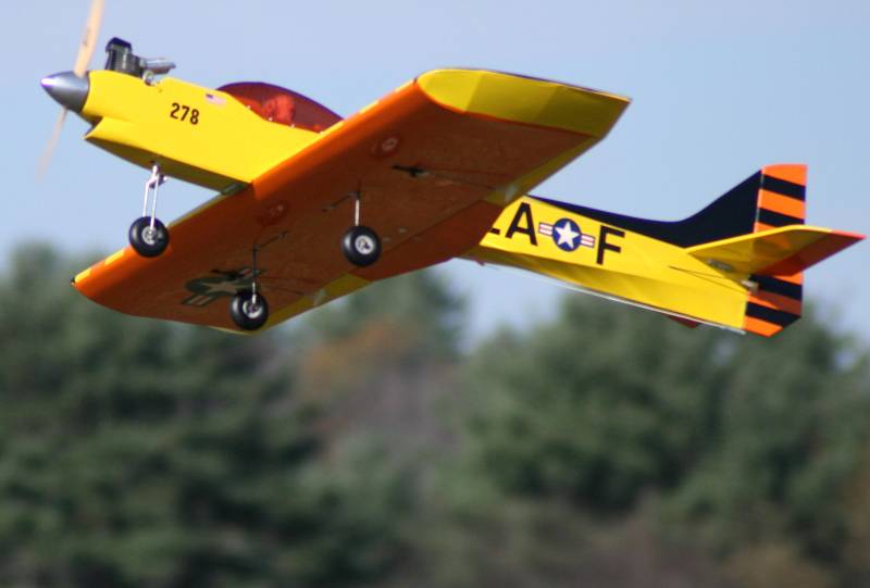

I fly off grass fields and I only have one out of 13 planes that has a nose wheel. That one has a Fultz dual strut nose wheel.
A friend of mine hates tail-draggers. I hate trikes. It mostly depends on your field. Rough, grass fields do not encourage nose wheels.
