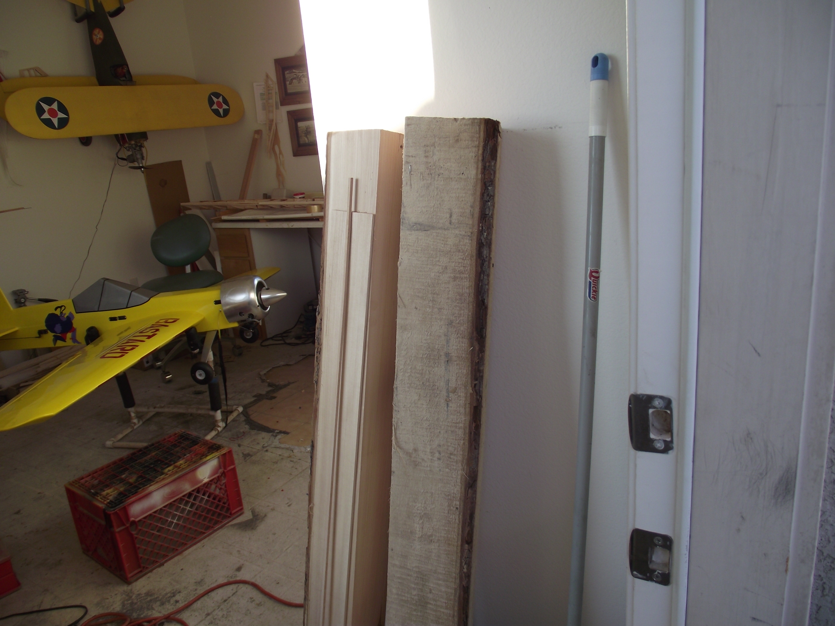

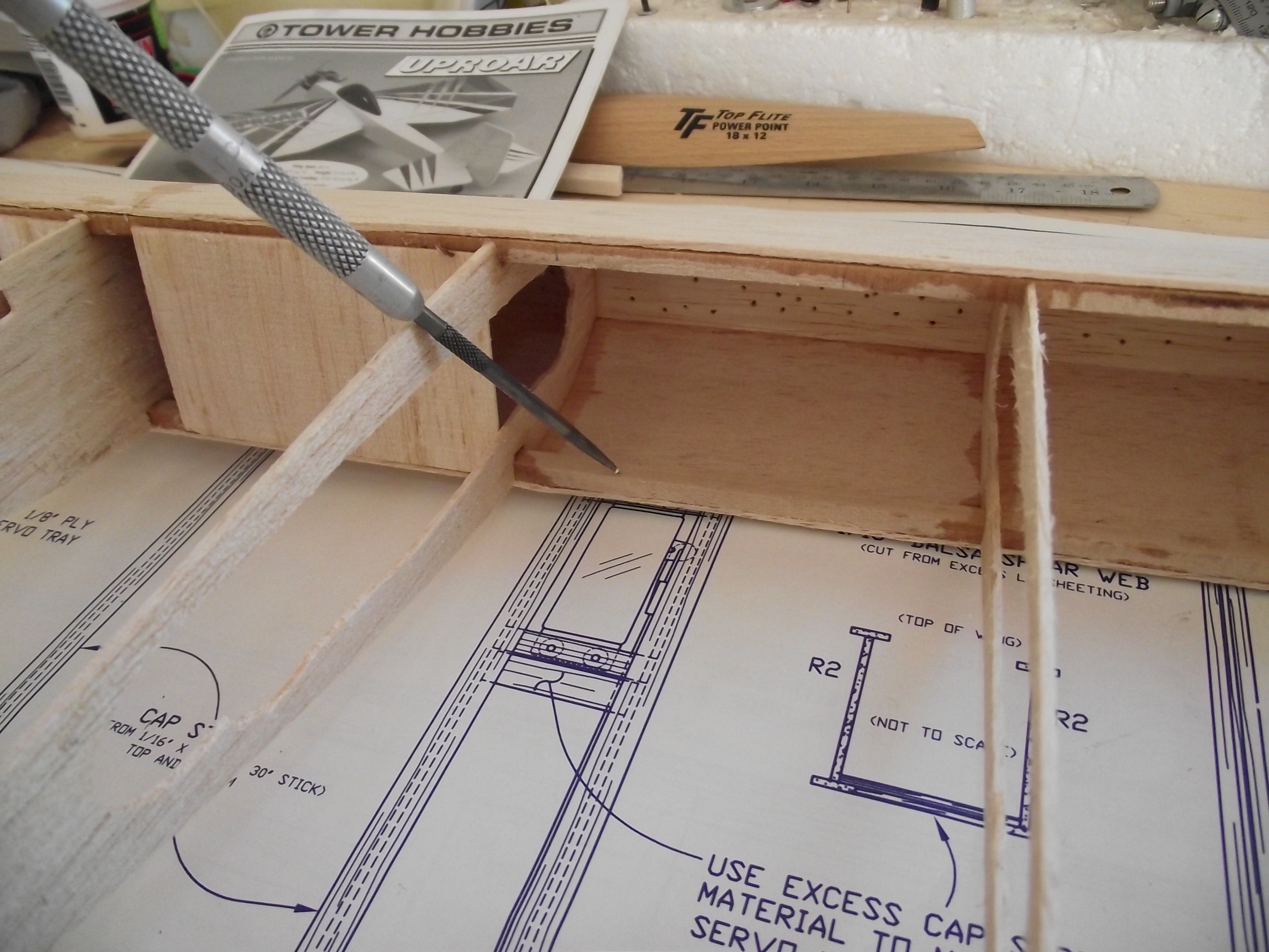

Just a mite confused but isn't this a spar. I understand not using bass wood for a joiner but every kit I have ever built has either a bass wood spar or a balsa spar. I just finished a wing for an Up-Roar and it used bass wood spars. In my case this isn't a kit but one of my rip off scratch builds and I cut my own wood. In this case this wing has a top and bottom 1/4 sq. bass wood spar. Is the OP asking about a spar or joiner?? I keep two big blocks of bass wood on hand just for cutting spars as needed.

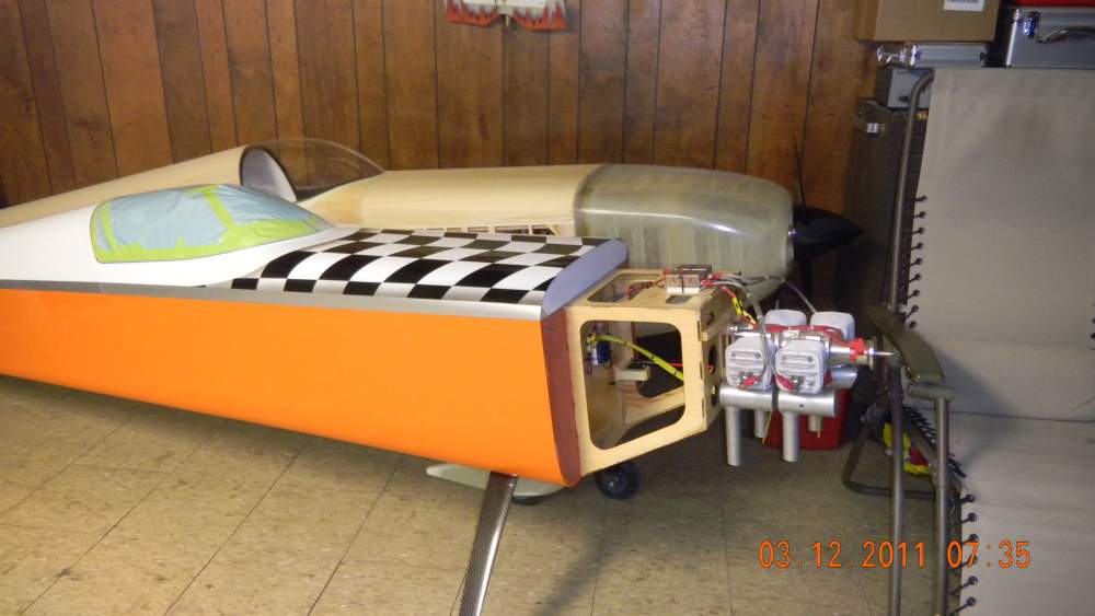

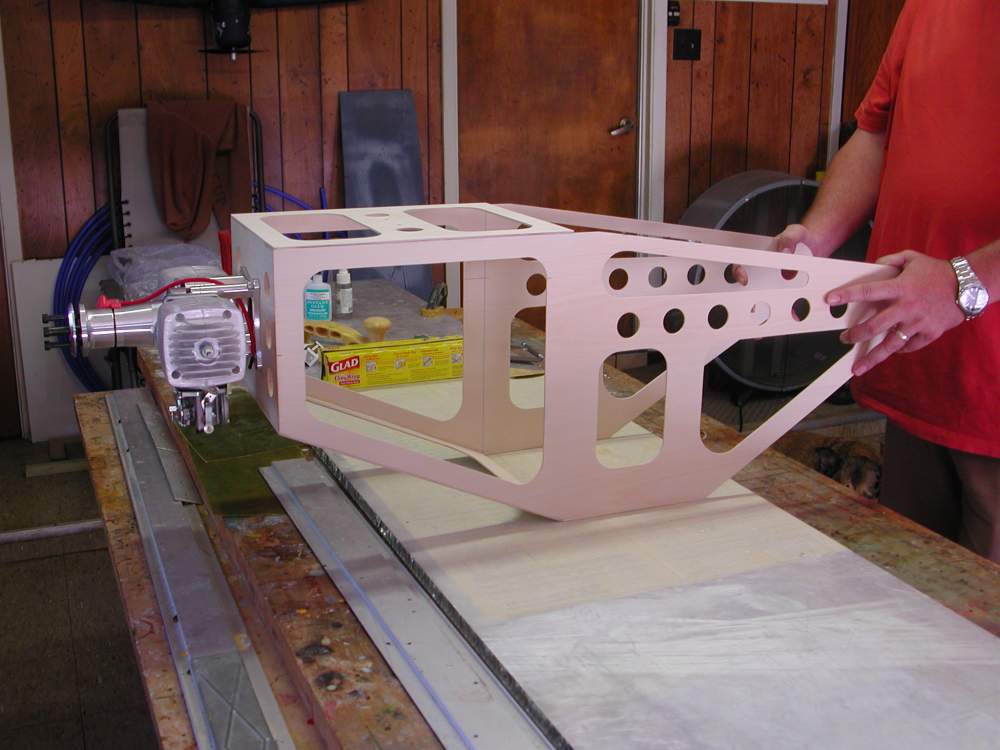

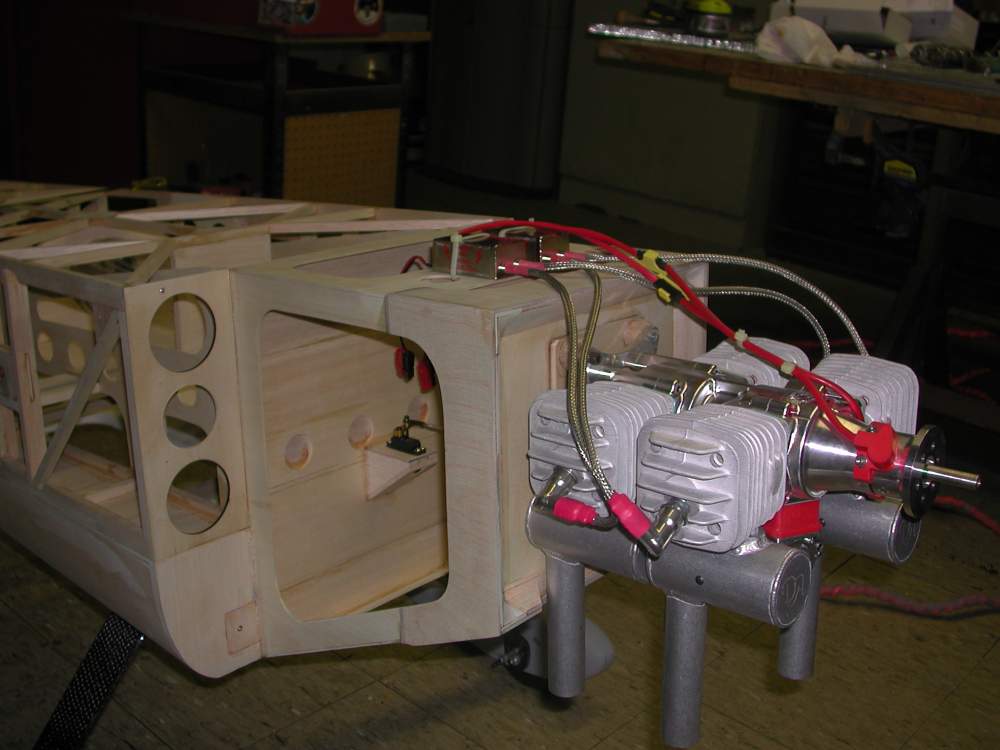

sensei's Avatar
Posts: 2,829
Received 17 Likes on 15 Posts
From: SAN ANTONIO, TX
In regards to plywood, Fact: Basswood plywood meets mill spec. 6070 aircraft standards and is just about as strong as birch plywood and almost as light as light ply. With that said it a much better choice then either birch ply or light ply because you get the best of both worlds in a properly designed airframe. I have been using primarily 3/32" thick basswood plywood from Aircraft Spruce & Specialty on all my giant scale stuff like motor boxes wings, tail feathers and fuselage components without a single failure to date so I don't see anything wrong with using it as a doubler in a wing.
P.S. I do use 1/4" thick basswood plywood for my firewalls and landing gear plates though, anyway just my point of view.
Bob
