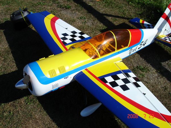

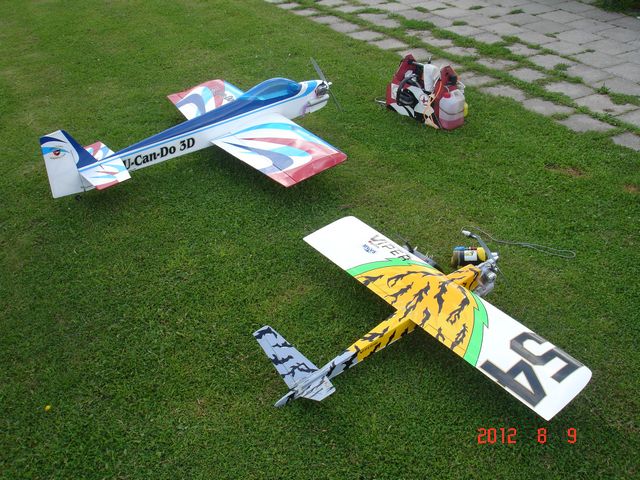

Old 10-08-2014 | 07:15 AM
Posts: 7,816
Received 10 Likes on 10 Posts
From: Upplands Vasby, SWEDEN
Hi!
I only use two fingers to balance my planes regardless of size.
