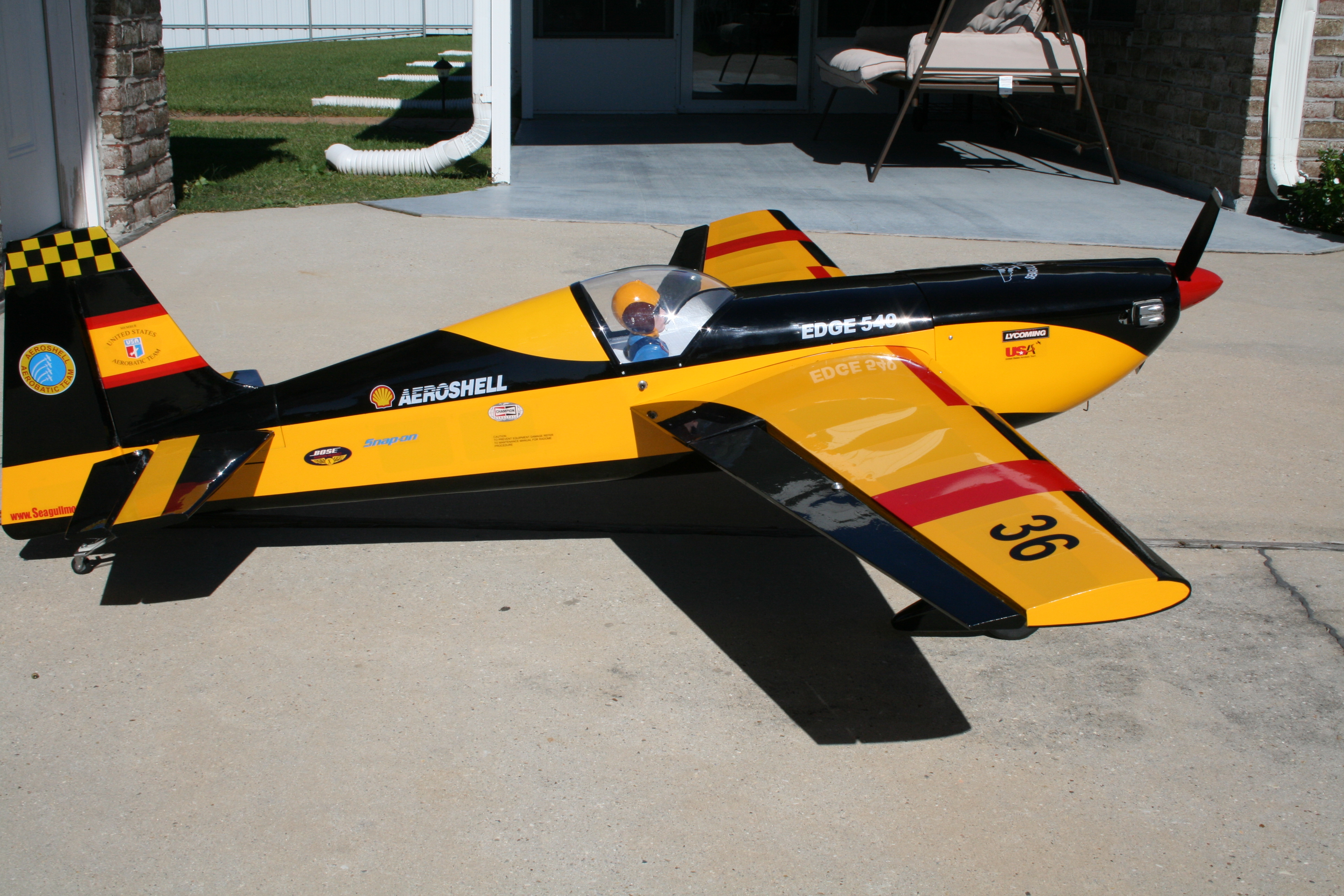

I have the Seagull 540 with the 66.9 in wing span. I had been flying it about 2 months ago and it was fine. Went to the field today and had major problems. I have the O.S 120 FS 4 stroke engine and my RPM get up to 9700. I have a Master Airscrew K-Series 14x6 propeller. My CG is 6.5mm from the leading edge it balance good. Now the problem I'm have is when I take of it flies like its under power real slow and sort of tail heavy. Can only make one lap and have to land it. Please!!! any help will be greatly appreciated.

Try an APC 16X6

I used either a 15X8 or a 16X6 APC with my OS 120s. I did a lot of prop testing though with each new plane to see what worked best for me. The MAS props didn't work so well and a 14 is a bit small. Also as our temps start to go down the engine may also need to be fine tuned too.

Have the same engine on a Stearman and even aero tow two meter gliders with it and just checked and an APC 15x6 has done a creditable job, in fact its the original prop since I started flying it few years.back. a 14x6 sure sounds under propped to me.
I am not really a fan ot those Master K Series and if you look at them carefully in comparison to the same size APC and look at the blade planform you will find it has about fifty percent more blade area compared to the APC, Its a humongous difference. Also not convinced its just a prop problem since you said it was not the same last time. Could it not be a simple tuning problem and did you retune from two months ago? That's enogh for a season change and definitely may require a simple retuning.

Depending upon some manufacturers published rpm to define whether or not your tuning is ok is a mistake. To properly tune to the high speed the engine is leaned out to peak then backed off a given RPM margine or as I do is use the pinch method and a brief pinch of the fuel line at full power. If that imediately kills the engine then the main needle is too lean or if the pinch results in a brief increase in RPM then the needle is too rich.
The 15x8 may be a bit to much pitch.

Re-tune so it reaches max rpm and then back the needle out just a bit to make the mixture rich and fly it. If it "sounds' like it's stumbling or not reaching full rpm at high throttle you may be to lean or too rich on the high speed needle. Bring it in and feel the engine and if it's really hot you are too lean back out the HS needle a bit ; if it's not really hot then it may be too rich so turn in the HS needle a click. May need to do this a few times until you get it right. Also the low speed needle may need to be adjusted as well depending if it stumbles from idle to full throttle(too lean) or if it bogs down and throws out a lot of fuel/smoke(too rich) The low speed needle will affect the high speed needle setting.
When you get it tuned and if it still doesn't fly well then get the 15x6 APC and repeat the process.

It flew OK 2 months ago and it still makes maximum RPM on the ground.
If it was the prop, it wouldn't have flown OK previously. If it is too rich, it wouldn't make maximum RPM. Also if it is too rich, once in the air it would lean out and run better.
The only thing it can be is too lean. Run the engine at full throttle, then point the nose straight up. If the mixture is correct, you will hear the engine RPM increase slightly. If it is too lean it will die off.

If your getting that 9700 RPM while the plane is stationary and on the ground, your over reving the engine due to your prop being too small, as the engine will unload and rev a lot harder in the air (ie well past the recommended max rpm).
You should look to get only about 8600-8700rpm on the ground if your motor's maximum rpm is 9500, as it will unload and reach those maximum RPM's while in the air.
