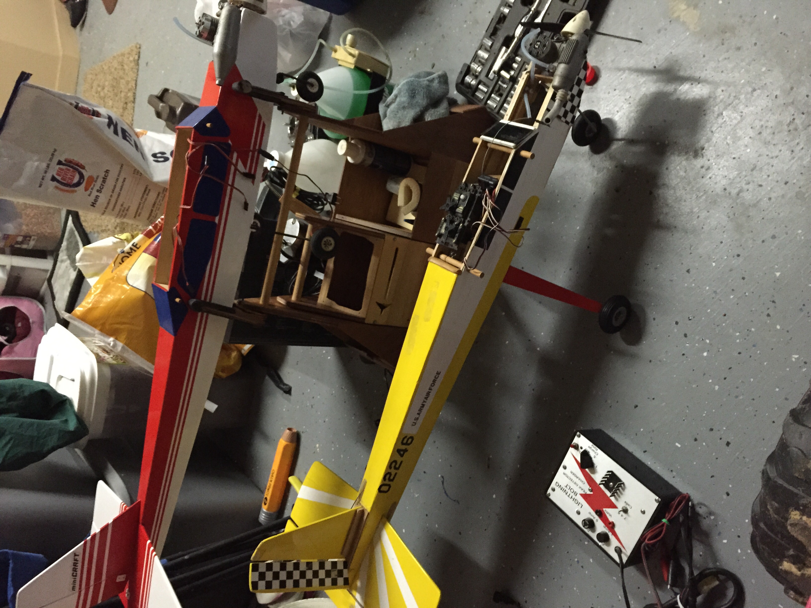

I posted some pictures on my profile. Please look and see if you can tell me what kind of planes they are

Well, without the wings on them and the angle of the picture, it is very difficult to identify the planes, but they certainly look like fine examples of the hobby. Would it be possible to post more and better pictures of them from several angles and with the wings on them? They look like very flyable planes to me. Guys in your club or area would be more than happy to work with those planes and help you get them flying. It sounds like all you really need to do is sort out the radio equipment and get on a buddy box with someone. Are the wings flat or do they have dihedral? Do they have ailerons or no? I suspect they have flat bottoms, but not necessarily. Those are a couple really nice planes. Keep us posted on what happens with them.

All the other pics are on my gallery profile. The wings are installed on a couple. Red plane has ailerons and one does not. Both has steerable landing gear. Yellow plane is a 4 channel and red on is a 3 channel

You're backwards, the yellow is a 3 channel and the red is the 4 channel. That what your pictures show.

Look like decent trainer planes. Your one plane is missing the muffler pressure tap. Most enyas will tune and run fine without it. Get good batteries for them. At least a 5 cell nicad pack. 4.8v 4 cell packs dont give you much margin with spektrum 2.4 systems. The radio that came with the planes probably dates them to late 80s to early nineties. I would advise you to change the switches on them too. Look over the wires on the old ones for signs of corrosion, they may be ok even though they are old. If the old batteries were left hooked to them for years they probably have black wire corrosion and are shot. That said, I have had 3-4 new heavy duty switches fail in a short time-- far more than the old stock switches that may have 20 years on them.. Sucks to change out a 20 year old switch for insurance and have the new one fail after 10 flights...... have fun!!

The red and white plane looks like a SIG Kadet.

Ummm, could it be a Mini Craft Red Arrow 45T like it says on the plane?
