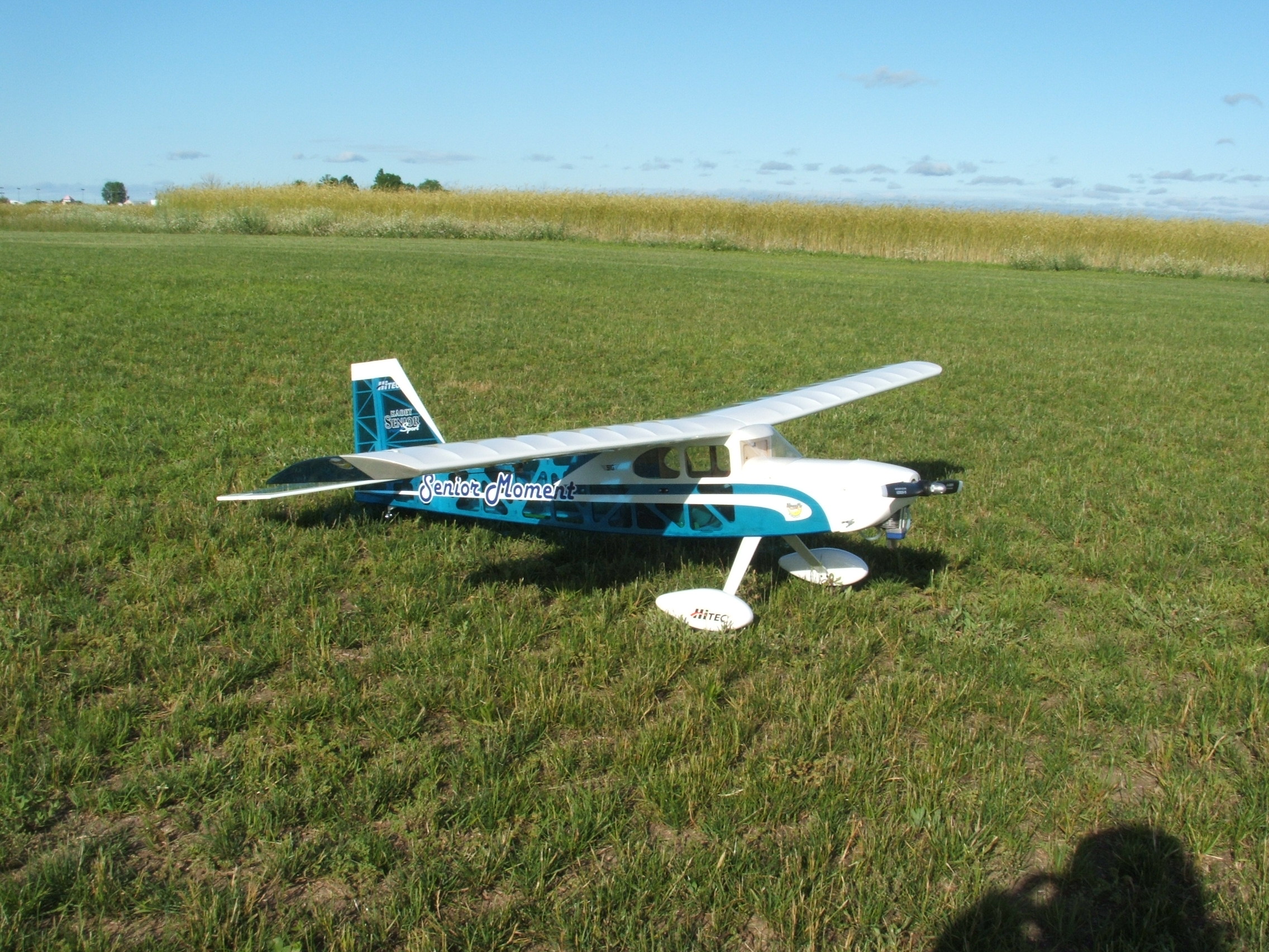

Inverted engine trouble is usually an installation issue. I've been running them inverted for years with no problems.
Place the fuel tank as Grey Beard suggests and all should be good.
