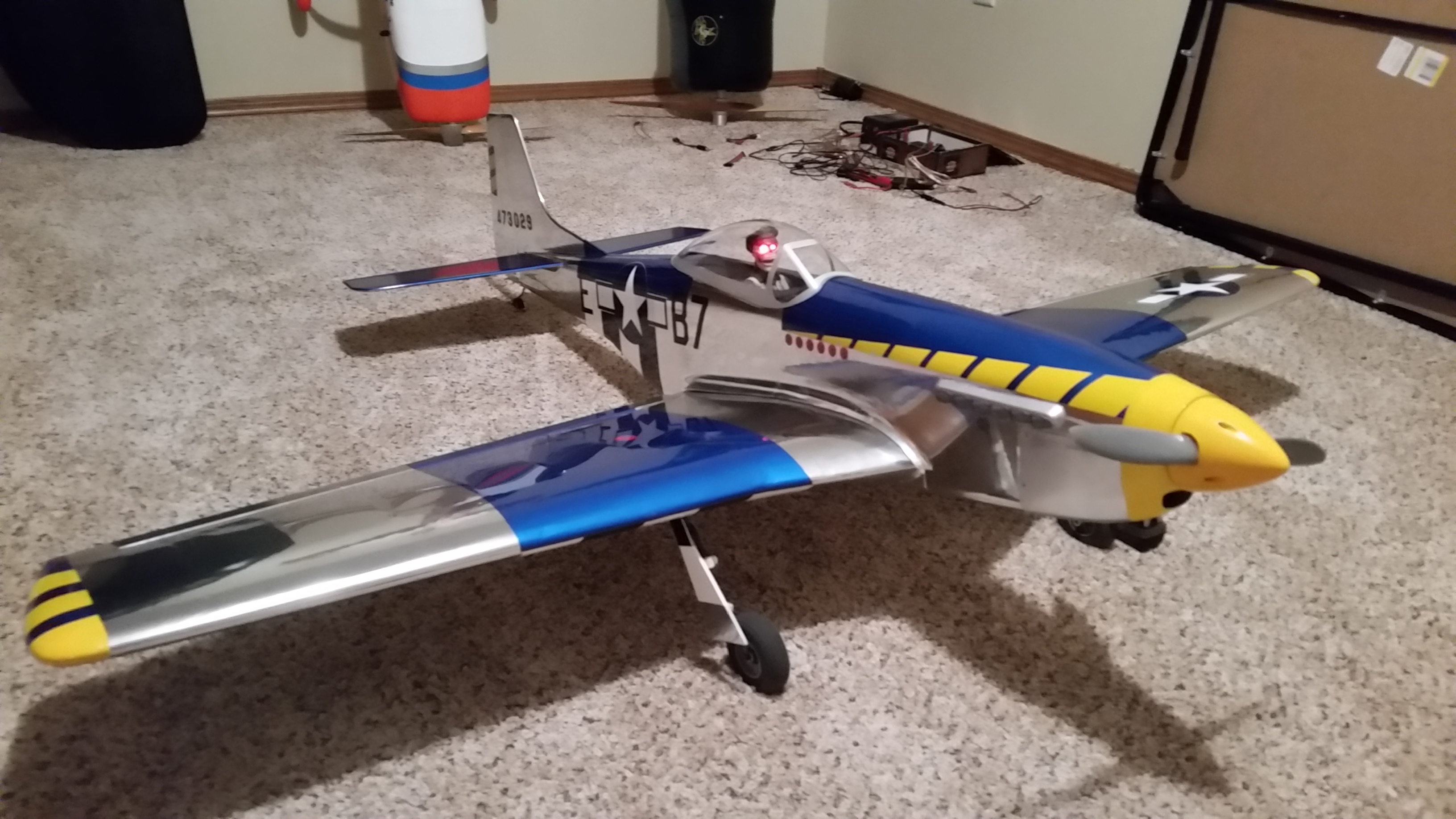

Joined: Aug 2008
Posts: 45
From: Syracuse, IN
I have it on a great planes mustang kit that I have built. Actually its the third time I have built that kit. Man, that Surpass II with the Spring Air retracts on it is such sweet rig. One of the best flying planes I have ever owned.

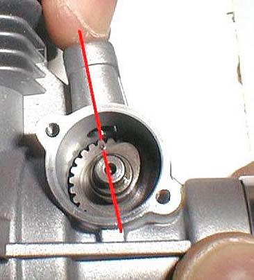

Old 07-14-2015 | 07:45 AM
Bax
My Feedback: (11)
Posts: 19,483
Received 8 Likes on 7 Posts
From: Monticello, IL
When the engine was reassembled, was the camshaft installed properly? Here's the way it's supposed to go:

Bax When the engine was reassembled, was the camshaft installed properly? Here's the way it's supposed to go:
Yes, made very sure that the timing was correct.
