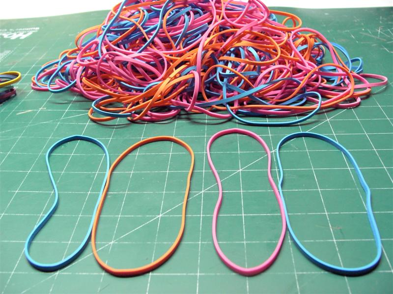

I have been using these now for several years since I discovered them at Walmart of all places in the stationary section, and they have made the old #64's obsolete for me.
They are marketed as book markers, in a relaxed state seven inchs long and they are approximately 1/8th inch square. Have used them on everything from the typical 40 sized trainer to my forty year old Super Buckineer that has a twenty inch wing cord. The smallest is in fact my Apprentice which I sometimes use for training. On that one the seven inch band works perfectly with just a single double back.
John

John, Those look interesting. I only have 3 trainers with rubber band type wings left and 2 of them have a 12" cord so the bigger bands may be good. I'll look at them next time I'am in Wally World. I am not sure what plane I would use the pink ones on though!

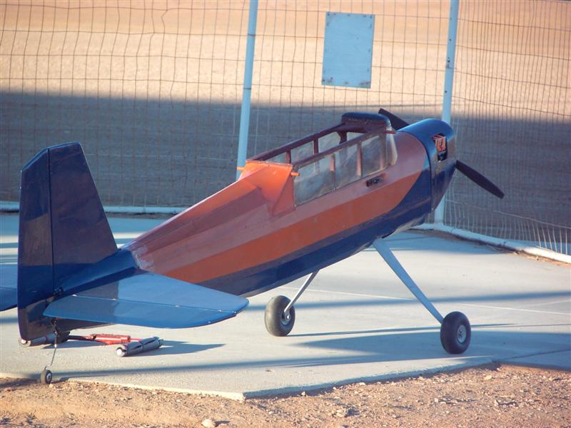

There are other reasons beyond what most just assume and among them are fidelity to an orginal design model not necessarily a scale type model.
I have a number of vintage type aircraft that would be just plain 'Wrong' without a banded wing. The most striking of which is my very vintage giant Berkeley Super Buckineer That weighs almost forty pounds and yes just would be wrong without the banded wing. It requires approximately the entire amount pictured in the photo above for flight.
John

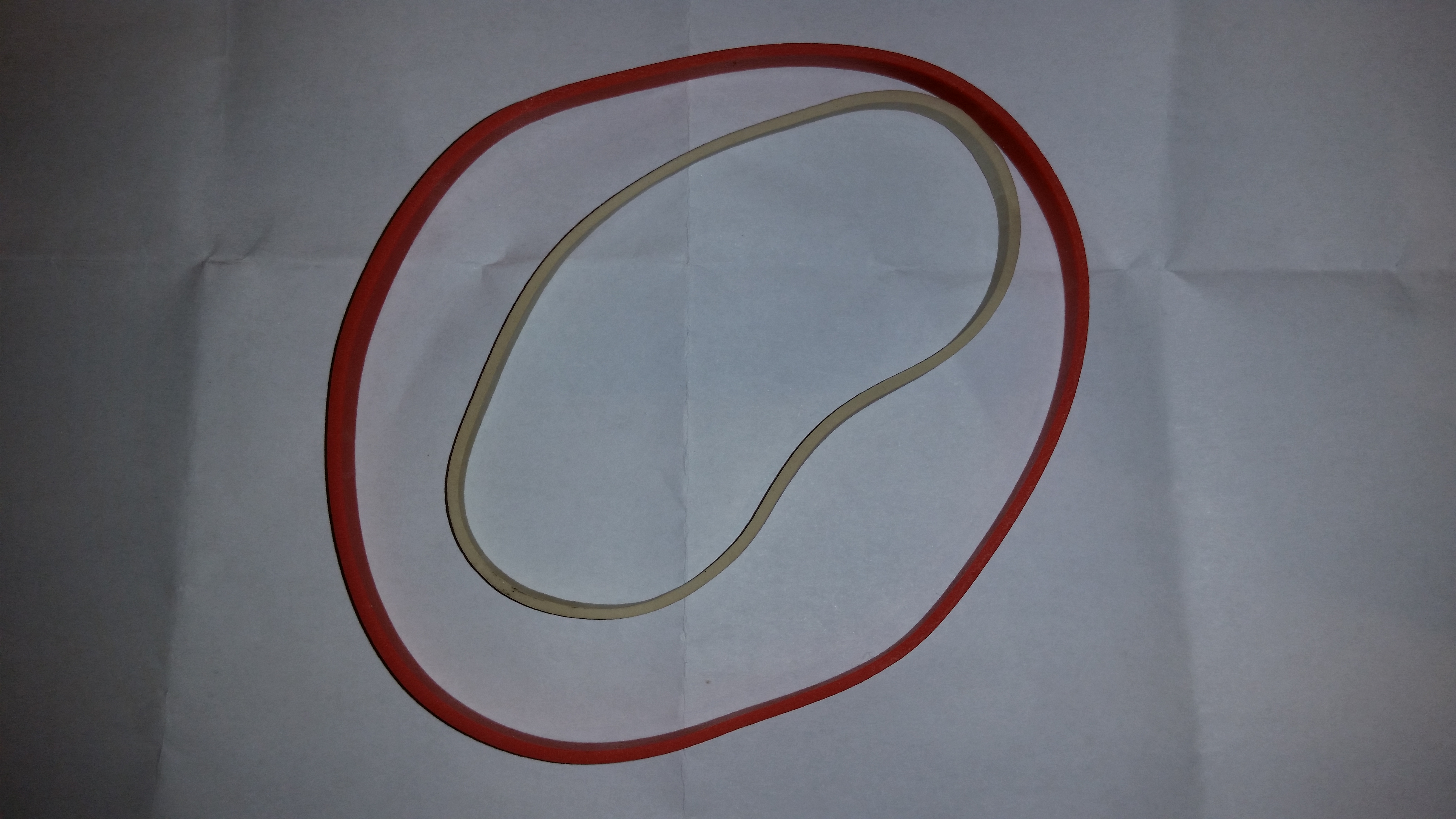

Default Testing tensile strength
All this talk about wings falling off mid air and not enough rubber bands got me a little nervous. So I did a little test using my digital scale. I stretched both bands (stock) and the Alliance Red Packer Band to 10 inches in length. The stock band provided a tensile strength of 2.0 pounds at that distance and the Alliance came in a 2 pounds and 5 ounces. The Alliance band is thicker and wider and even though longer provides a higher strength. I also think the red color adds a bit of pizazz.
Now I feel better. Phew.
Attached is a picture of both bands.
