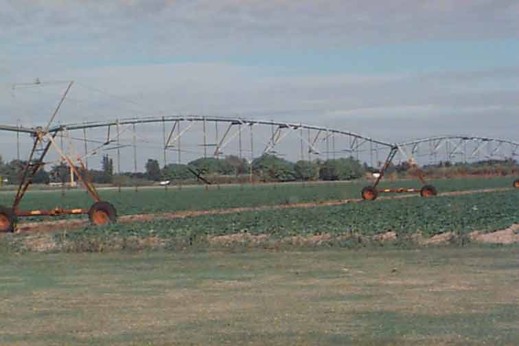

By the way this is the Nemesis of my flying field, if you fly with us and you have not hit it yet, you will at some point, I did it when I was learning, in a landing approach, no damage, but for other guys they planes have desintegrated in some wierd accidents.
