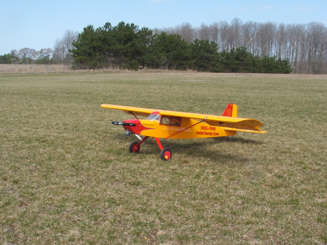

I think that you are on the right track. With a little imagination, and a few modifications, easy to fly sport models can become "scale models."
For the OP's skill level, Iwould suggest a Sig Kadet Senior. I modified mine into a tail dragger, added ailerons, and removed the dihedral. After that, I slapped on a Kadet Senior Sport cowl and covered the air frame in a "scale" motif.
I feel that this would be an excellent project for a novice builder and low time pilot.

I like Tom's idea... It almost looks like a Citabria, not like a pure classic trainer. Kadets fly great and have plenty of acrobatic capability to grow into.
