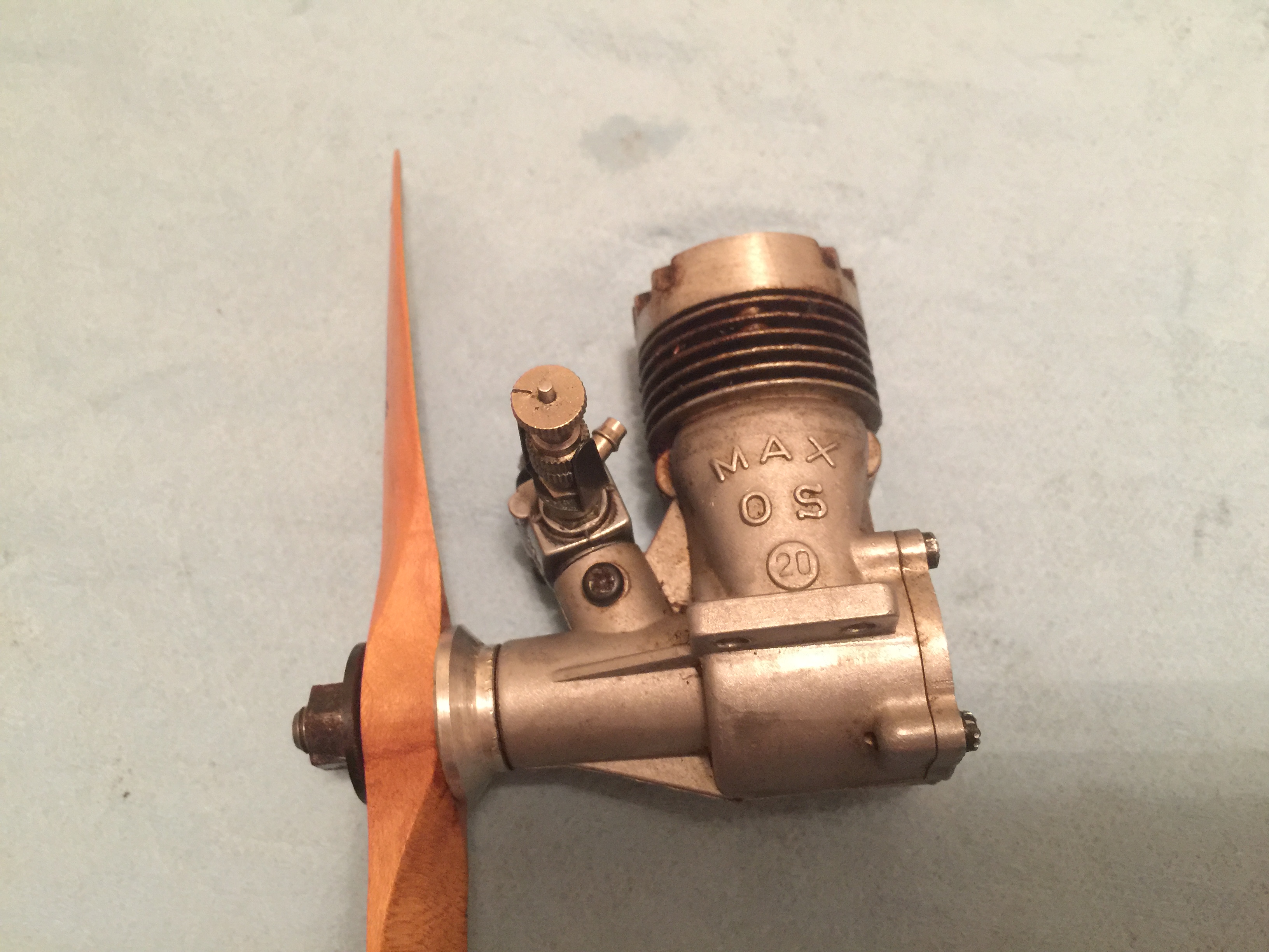

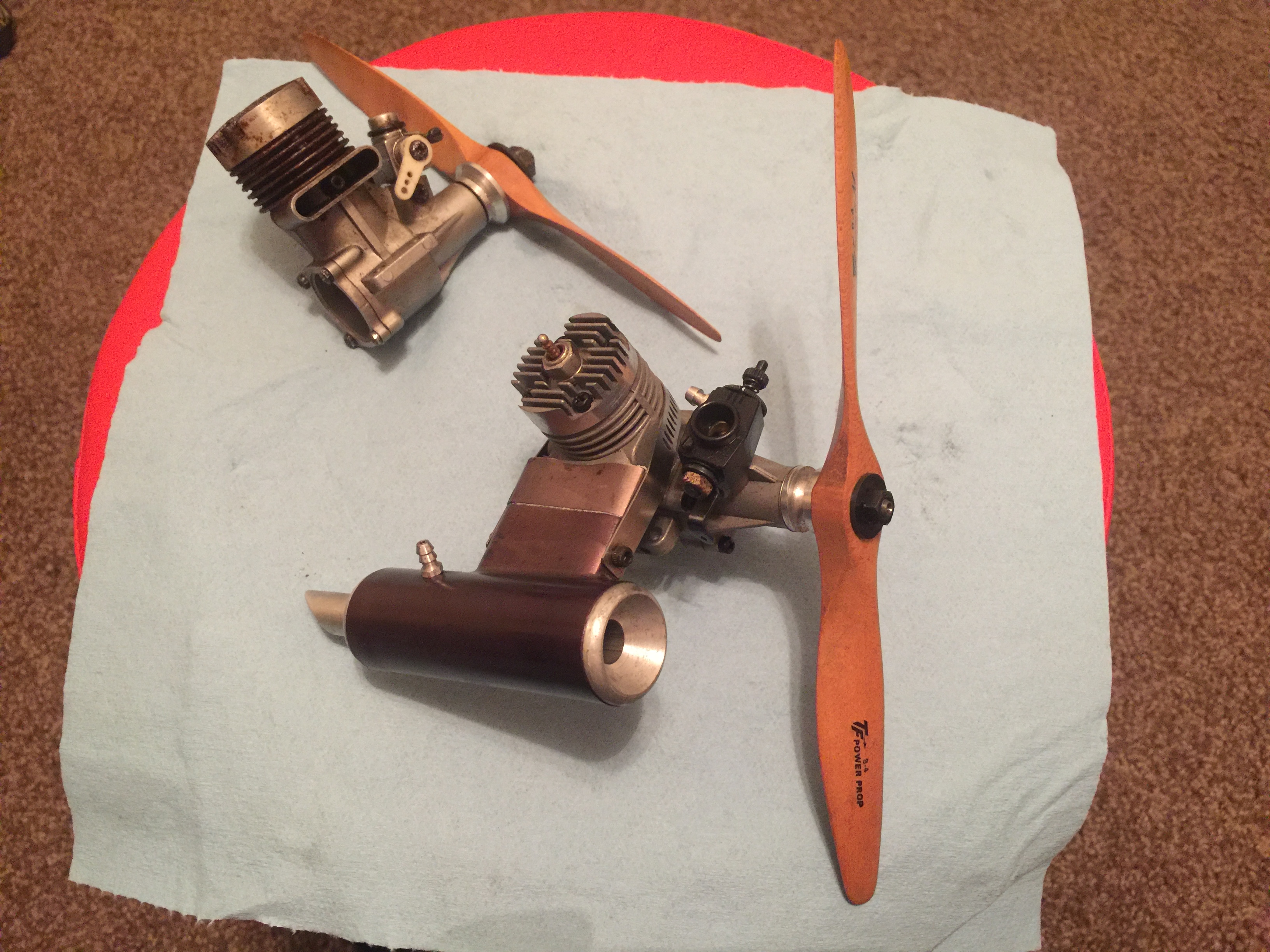

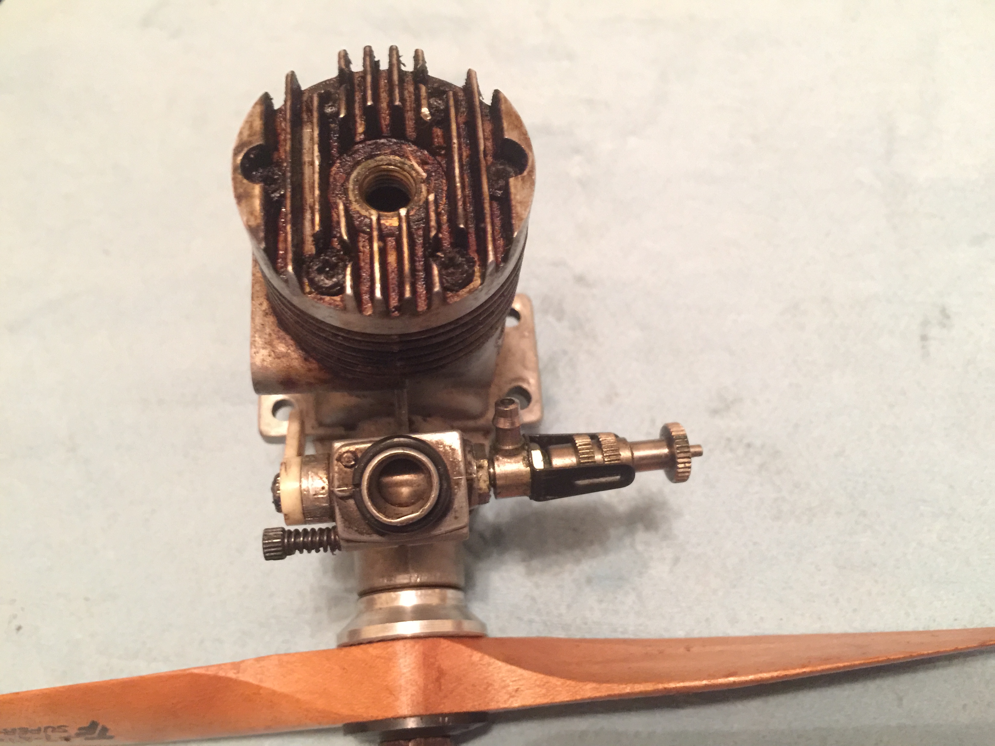

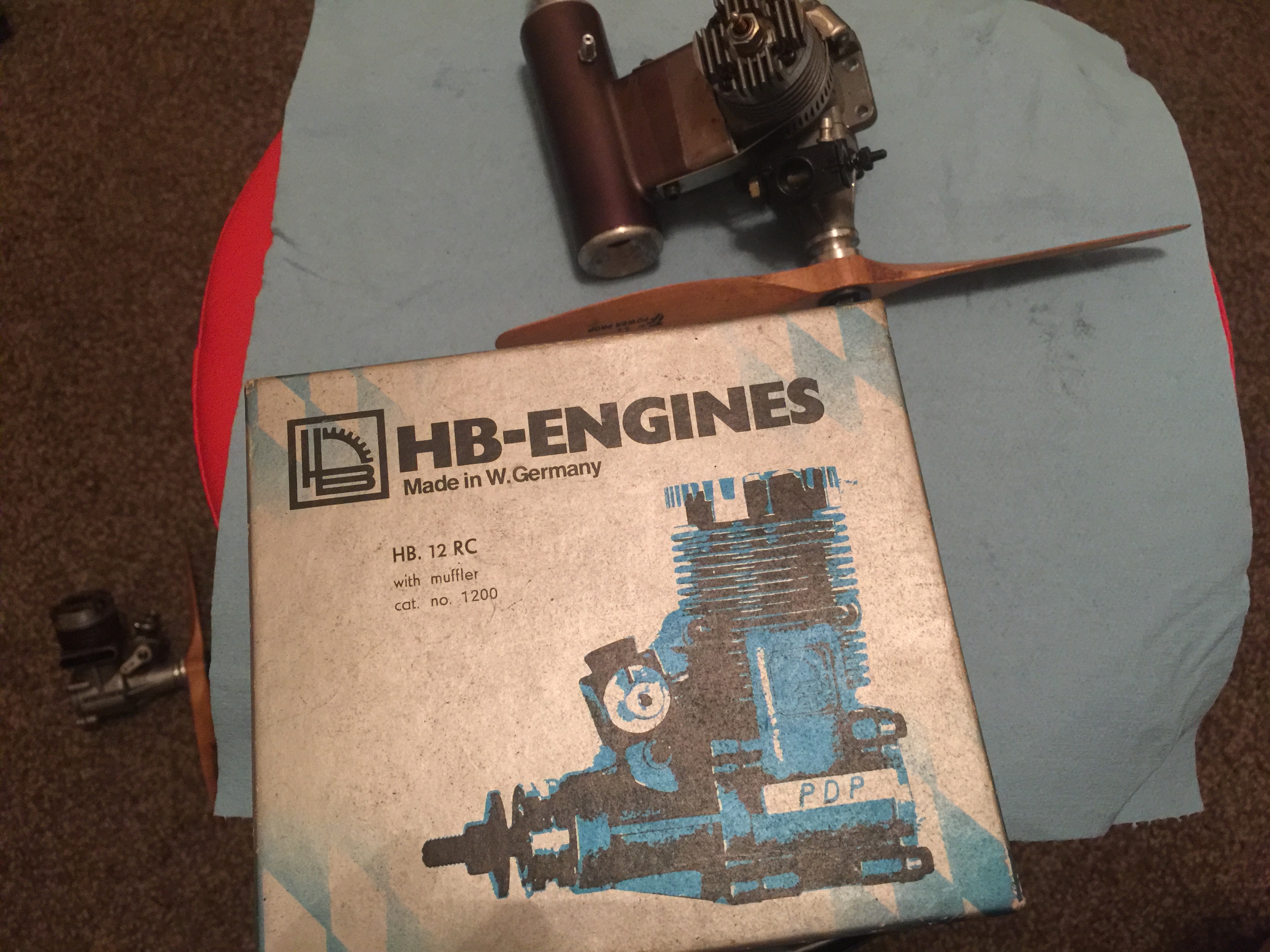

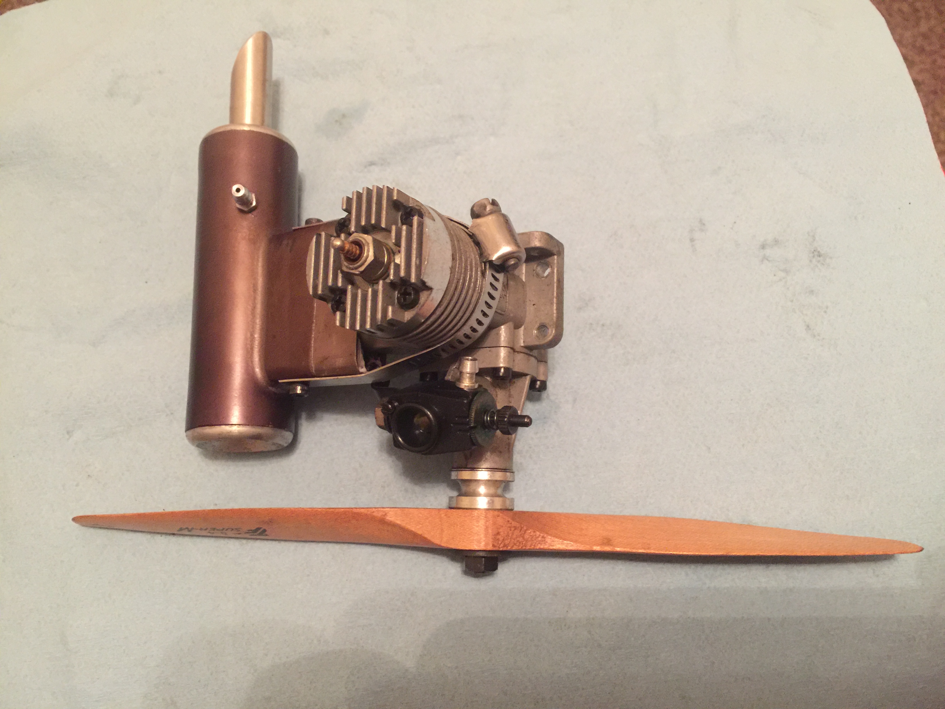

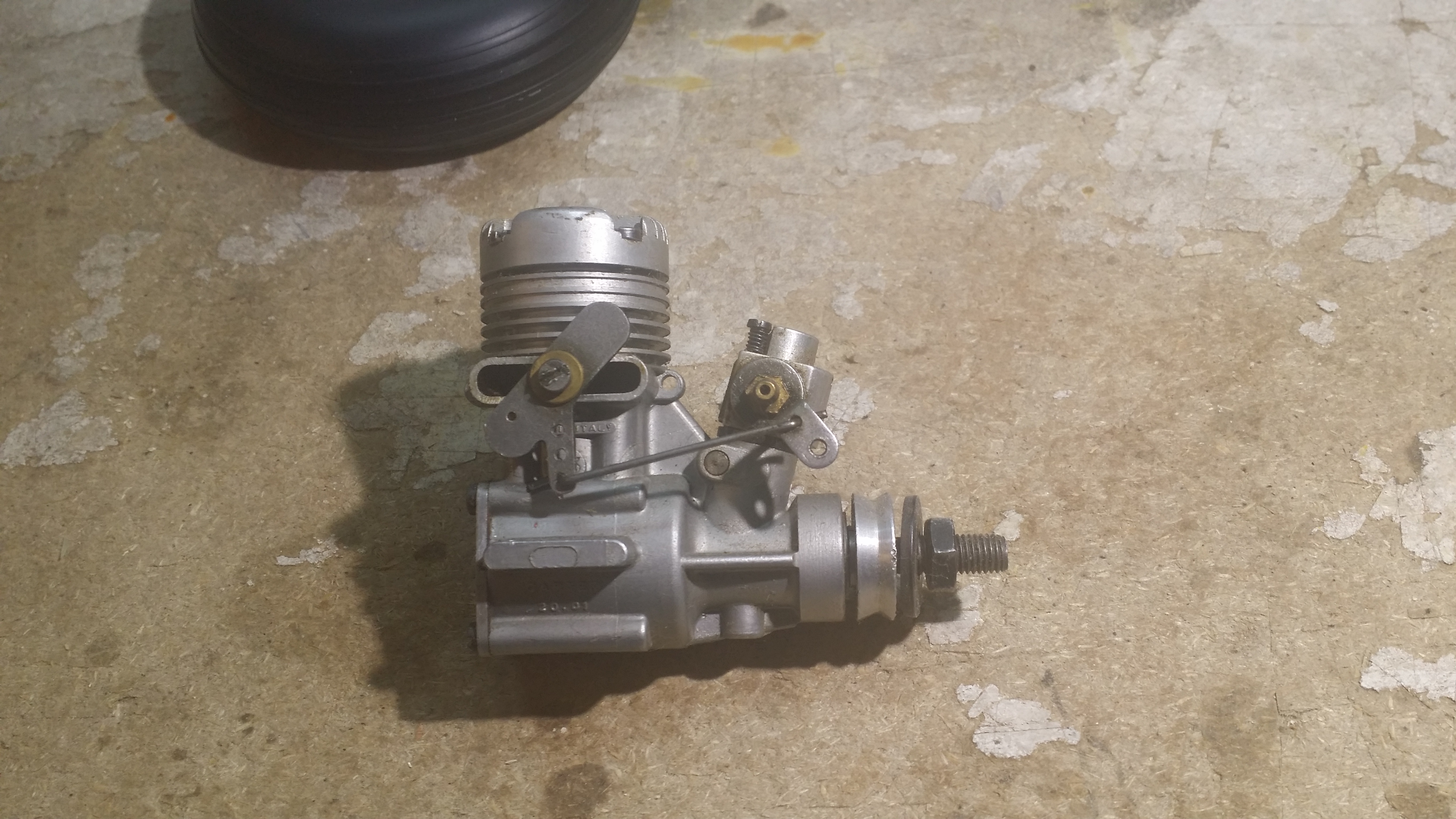

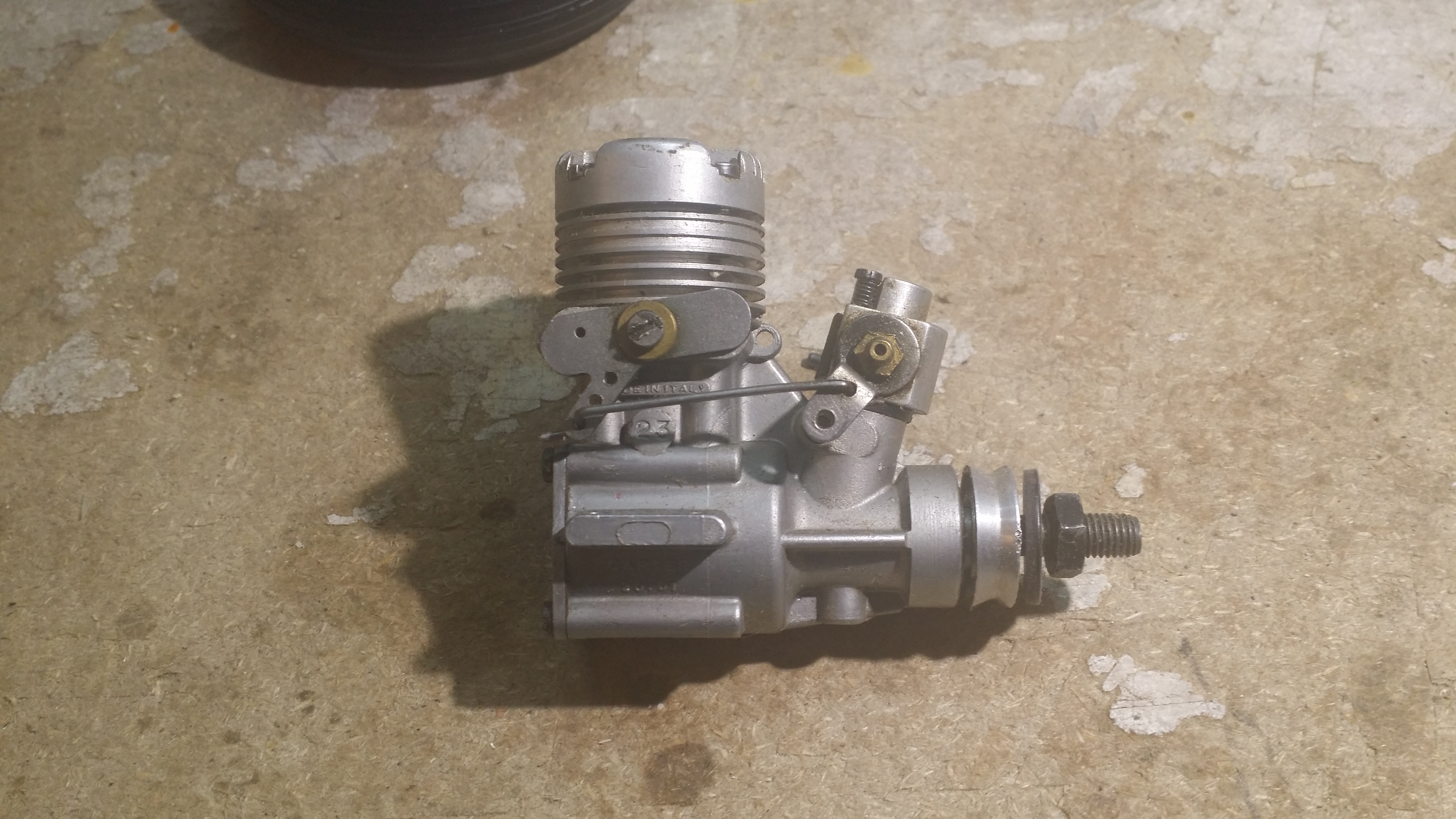

- HB .12 RC engine made in Germany fresh out of box, clean, I got it started and broken in on table top.
- MAX OS .20 missing muffler

- where would I find a muffler for the max os?

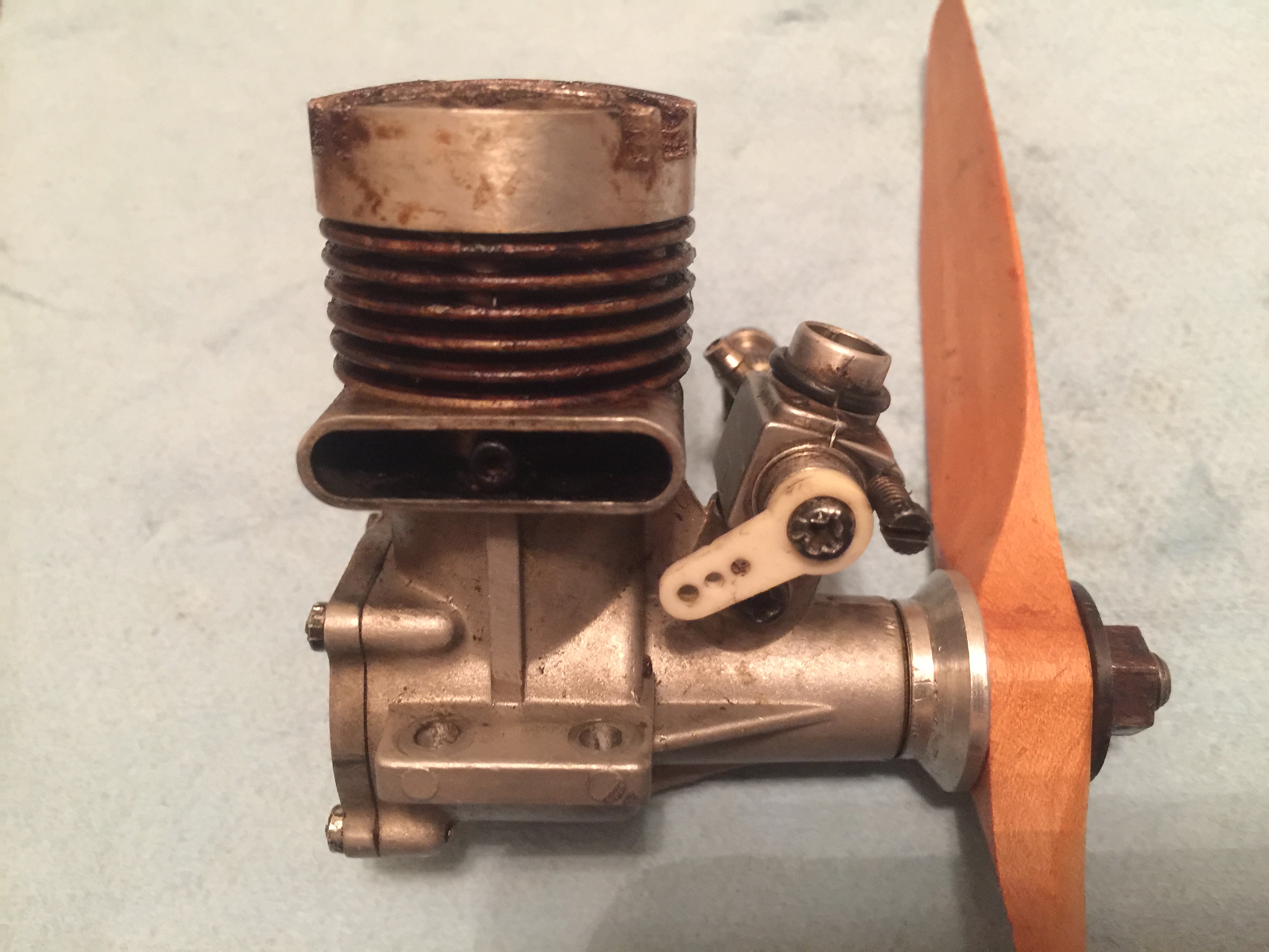

Newob The OS 20 you have is a much older variant that did not use mufflers. The lack of backpressure for for pressurizing the fuel tank was made up for by a slight decrease in the diameter of carb throat. In addition the articulated baffle design was intended to keep the glow plug lit during idle. This design for many earlier engine throttled designs worked well. This is why your engine has that screw hole boss in the middle of the exhaust. Also note that throttle arm is actually a carefully trimmed plastic servo arm. The original arm was metal.
The example I illustrated is not an OS engine but one of virtually identical design I have handy to photograph.

I have an old OS Max 20 just like yours. The OS 702 muffler was designed to fit the 15, 20 and 25 of the time and it works great. The throttle arm on mine looks exactly like yours. It is a great engine. Engines like this are available on ebay pretty cheaply because not many people use them anymore, but they are excellent. They have the great advantage for a scratch builder that it is easy to build planes for them and have a blast with them.
