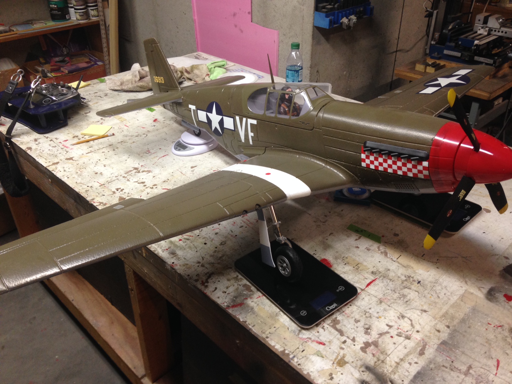

As a rule of thumb you should see about 15-20% of the weight on the tailwheel. If you find it varies much from that you may have a CG problem or have the main gear out of optimum position. Here is an example: my FMS P-51 with 3300 battery weighs 2605 grams and has 458 grams on the tailwheel. This is 17.5%. If I put in a much larger battery the CG would go forward and the weight on the tail would be less. Vice versa for a much smaller battery...the CG would be aft and the weight on the tail would increase.

It's with the tailwheel on the ground just as shown in the pic of the FMS P-51. I doubt it's "cited" anywhere since it's not really a factor that you should need to worry about. It's just my observation.
