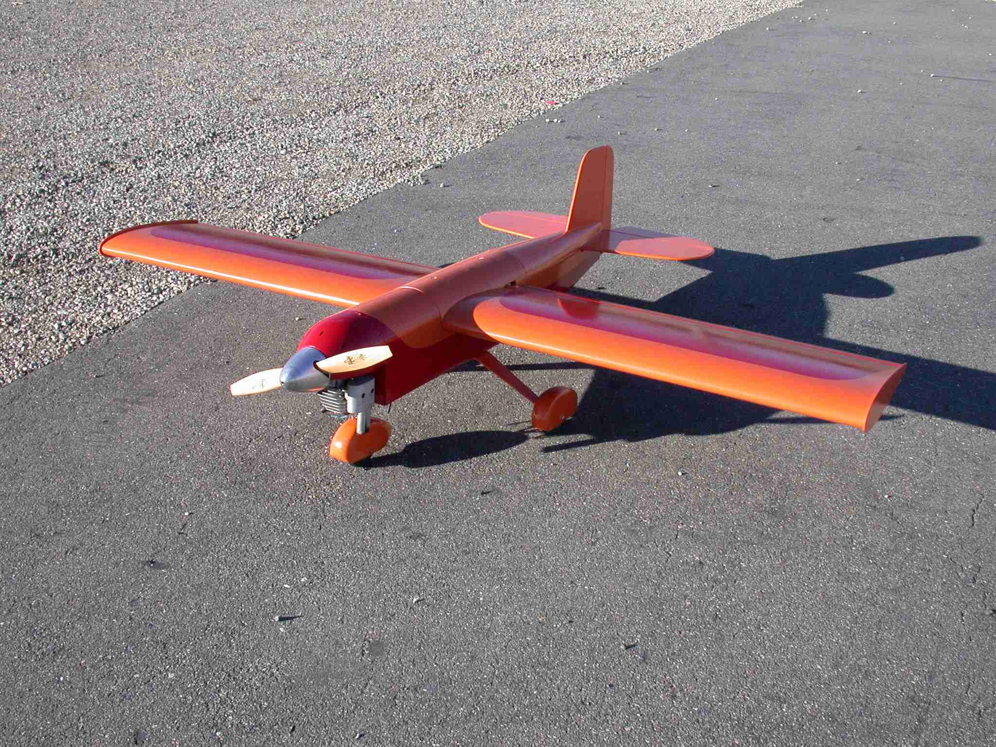

I use 1/4X20 nylon bolts tapped into a 1/4 inch plywood plate on my 20 pond 50cc powered plane. That's a 3/16 aluminum landing gear. It has survived many bad landings. Dan.
