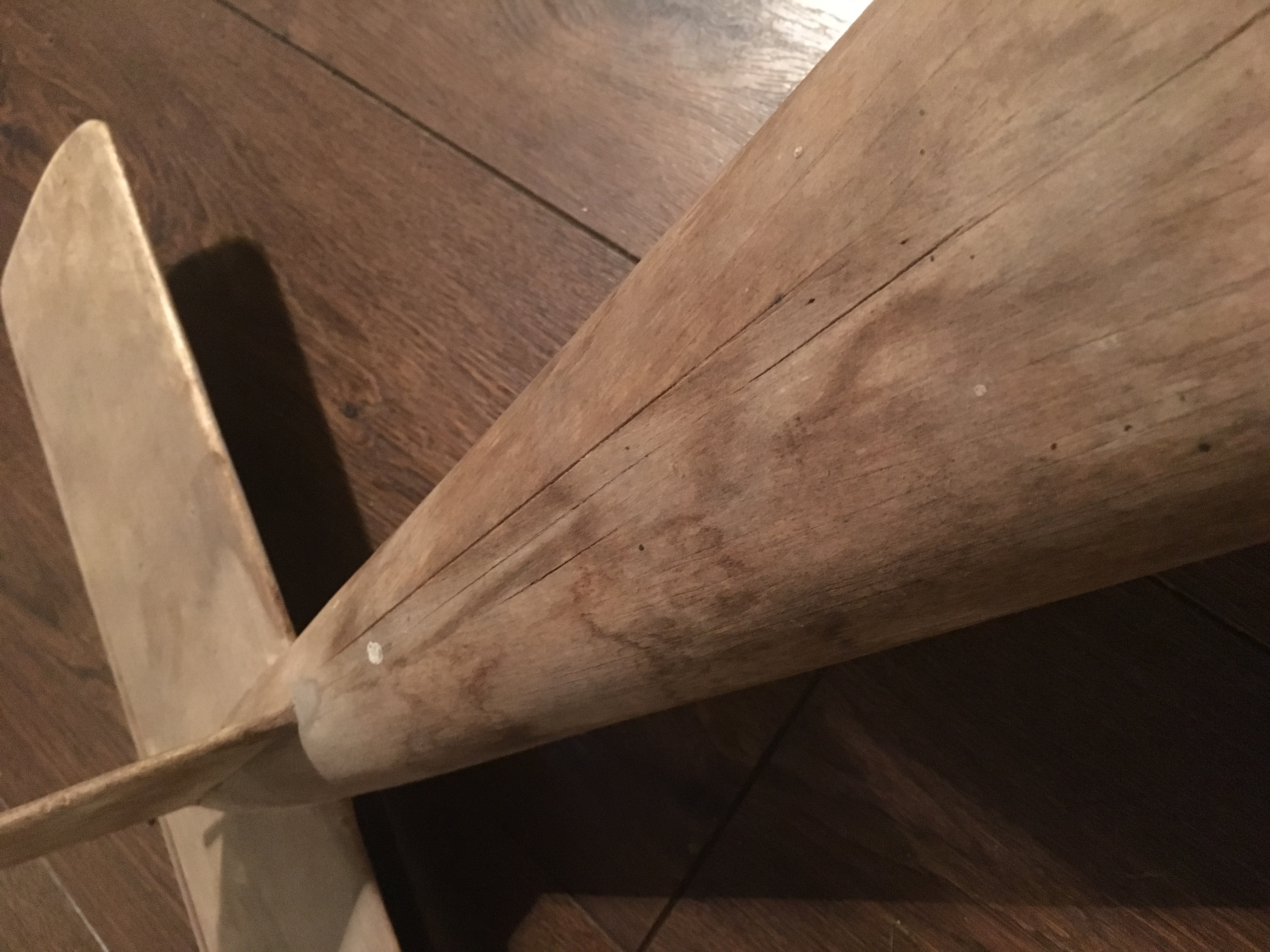

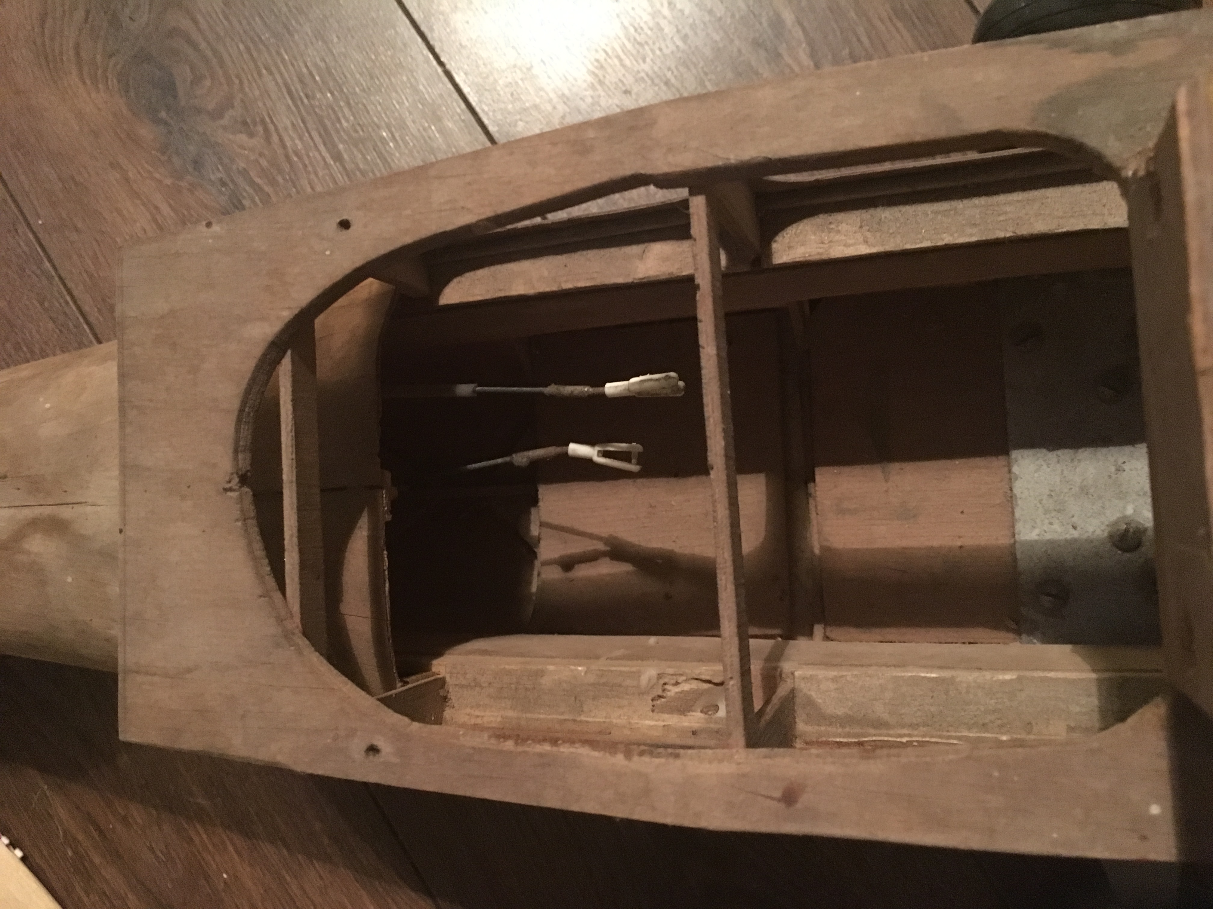

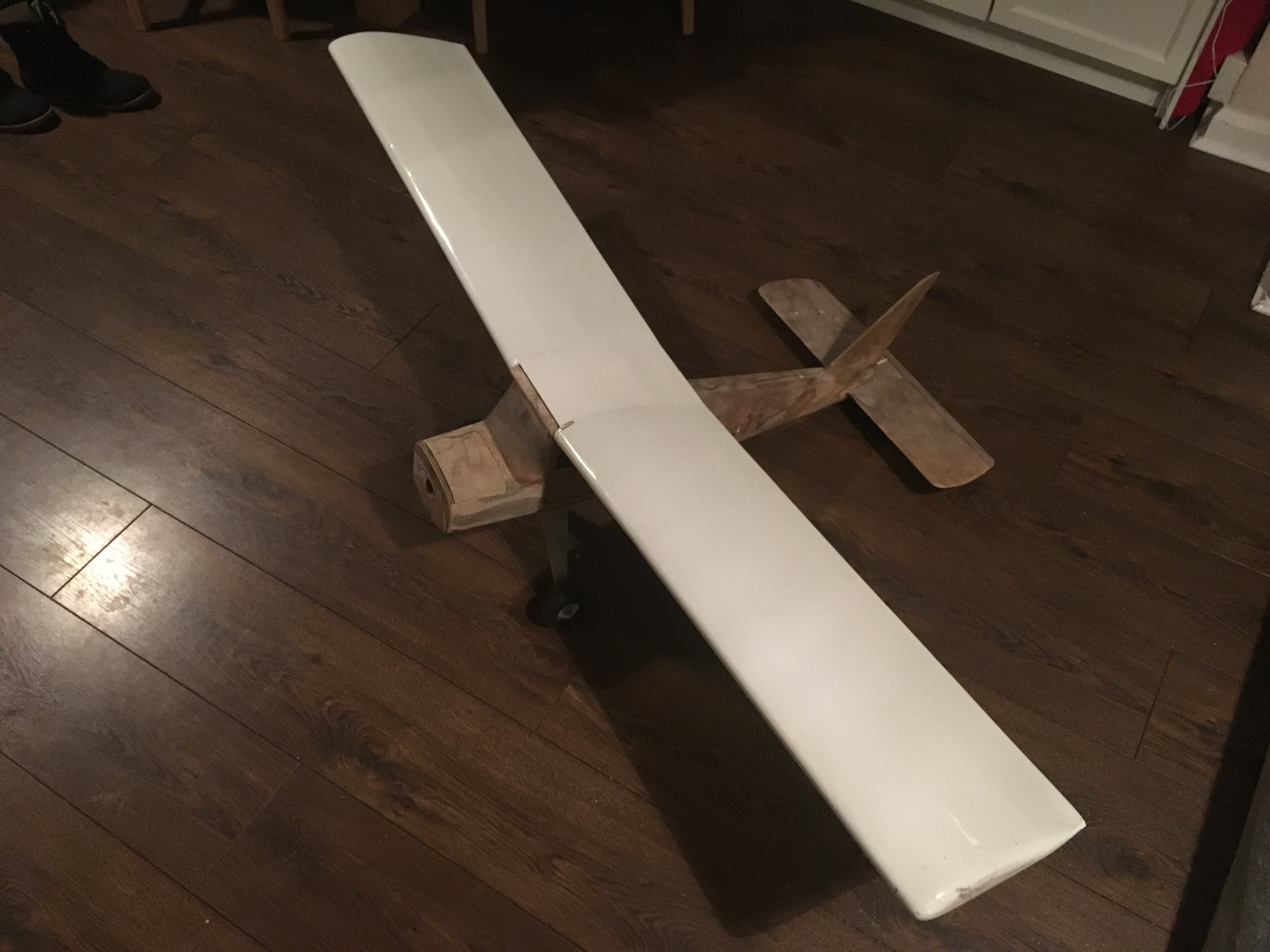

Hi.
If if anyone could spare some time and advice I'd be very great full.
A little while ago my partners grandfather gave our son one of his first ever planes he built that has seen better days. He wasn't very well at the time and my son accepted the plane as a gift.
Sadly he has since passed and I've said to my son and partner I'd like to refurb it to its former glory in memory of her grandfather.
This is where I plead for help.... I've never built a plane before. I'm very good with my hands and woodworking etc. I'd like to keep it as original as possible and will be hopefully using his motors etc.
As as you can see from the pictures the body is not in the best condition. How do I repair the bulk of the body as this seems to have started to crack and very thin. How do I re make the rear flaps and fix in the little hinges.
Basically i need to give the plane a full referb.
again please excuse my lack of knowledge as I've net done this Before.
Many thanks matt

Its difficult to say for sure but it looks to be like it has been in moist area and has dry rot . Its possible that it may never be safe to fly . Fixing it as a static display model might be the best thing you can do . Being good at woodworking you should be able to compare the wood in the plane to some new stuff and see what you think . If the wood is not punky and the ply is still solid then maybe you could refurb it . You will need to re glue all the old glue joints as best you can . CA works okay for this . It looks like you have throttle rudder and elevator only . I would build a new elevator as well as your rudder and rehinge them with hinge points . The windows are just flat plastic and will probably come out fairly easy and will provide good patterns for new windows . Good luck and have fun .

Hello, Matt. Just a casual look at the photos, it appears to be very dusty from lengthy storage in a shed or unconditioned attic. The balsa probably is still good, just needs a really thorough cleaning. I'd first carefully vacuum the fuselage and tail feathers with a soft brush attachment. This will remove the loose dust from the wood surfaces. Then lightly sand with 320 or 400 grit.
You may be able to clean the windows first carefully inside and out. Then use a plastic cleaner for automotive clear plastic headlight lenses (Meguiar's PlastX in US) to remove the window fog from the outside surfaces. The bare wood can be covered in a modern plastic film or painted. Product availability may differ in UK from US. If paint, I would use one or two coats of MinWax Polycrylic water based acrylic varnish with light sanding between coats, then spray "rattle can" Rustoleum Gloss Protective Enamel (reasonably fuel proof after curing). Cowling around engine can be made from several pieces of balsa or foam block, done in the old style like the planes of the 1950's, 1960's.
Red head's suggestion is excellent. Your best bet would be to seek out a model aeroplane club close to you, show them what you have. The experienced members then can help with advice, may be even provide hands on instruction to help you place this aircraft into flying order. The fact you are handy with your hands helps, and the experienced modellers can point the way.

I agree that the wood needs a good cleaning. Usually, the wood is in good shape underneath.
I've blown the dirt off of a couplle "oldre" airframes, and after a light sanding the wood usually looks like fresh balsa.

Since you plan for it to be a display model and not a flier,, the job isn't going to be bad at all. It looks like the wood has some mold or dry rot, so hit with some bleach to make sure that's not going to come back later to haunt you. Those cracks are from the wood contracting due to drying out. If you flow some thin CA glue into the cracks and then hold them together for a minute while the glue hardens, that will give you a permanent fix. You don't have to make it picture perfect, just structurally sound. I do that on planes I plan to fly again, so it will definitely be adequate for yours. Kill the mold, glue up the cracks, and cover it with Monokote or Ultracote. I think Ultracote is easier to work with, but some like Monokote better. Don't paint the bare wood. It can work out fine to do that on new planes, but it adds no strength and will look terrible on that old cracked wood. Rehinging the control surfaces will depend a lot on how they were hinged the first time. If they had pinned hinges (AKA, epoxy hinges), you can put a new hinge in the old slot and glue it. If it had CA hinges (a fabric material similar to felt) you'll need to cut them flush and make new slots with a hobby knife.
Once you are done with that, it will be up to you how complete to make it. Cowls can be made either with carved balsa or fiberglass. There are lots of tutorials here and on Youtube for how to do both. Then you'll install pushrods and servos and either mount a real engine or dowel inside the cowl to hold the prop for display.

Consider making the cowl from urethane foam, often used for insulation and comes in colors. In the UK usually blue.
Stick layers together if needed. Carve with a breadknife then sand to final shape. Cover with brown paper applied with diluted PVA glue. Two or three extra coats of dilute PVA, sand smooth with W/D then paint.
