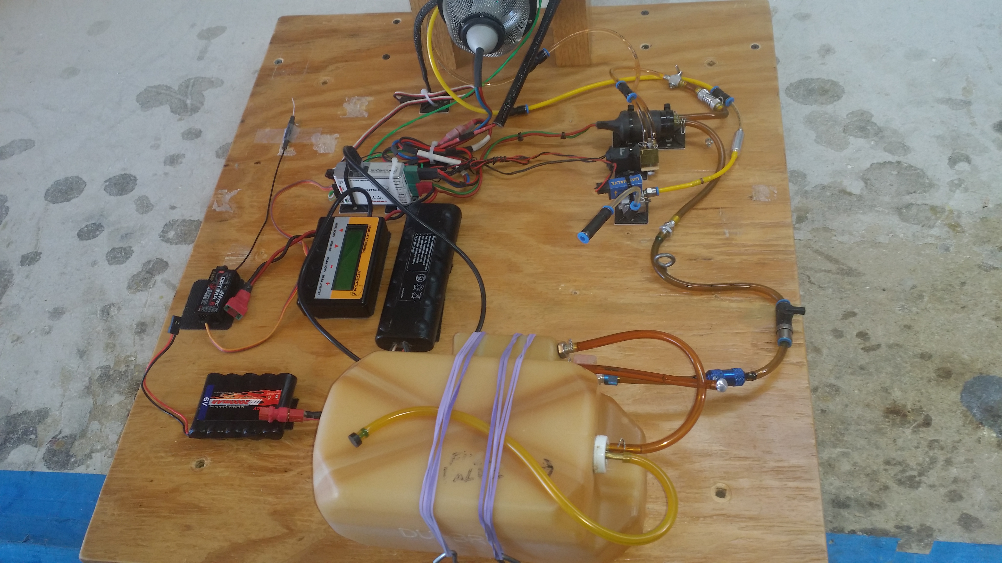

Now to your questions and yes a test stand can be useful in learning a new type of turbine or operationg procedure. Here is a picture of one I was using just last weekend to learn the use of propane start procedures since my three other engines are kero start, procedures are very different.
For a test stand and the one in this picture is the Dubro fifty ounce with the gasoline plug as well as gas safe clunk line. This is a reasonable size for you stand and is reasonable in size for the snaller engines.
Question #1
Yes you can use a variety of tanks however the stoppers and clunk line materials must be gasoline, diesel, kerosene and Jet A safe. Yes those fuels can all be used but only for certain engines and with certain parameter changes on your GSU (ground support unit) see your manual.
Question #2
The BVM UAT that you ordered will have an appropriately sized pickup tube and fittings. Another popular UAT and less expensive is the one shown in the picture. It is the Hansen UAT.

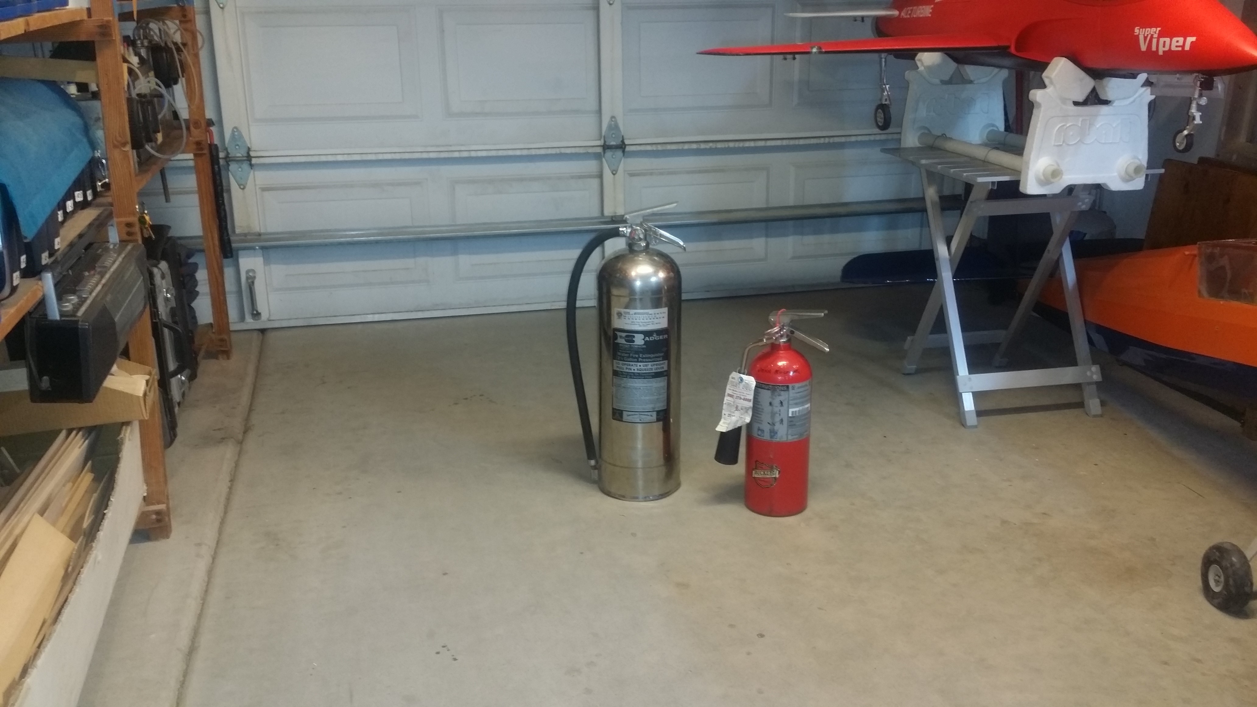

I'll second JohnBuckner's welcome to you, Buckeye320. Because I care about your safety and the safety of others, not to mention the reputation of this incredible hobby and your financial well being, I think it's prudent to say that your post sounds like the beginning of a significantly dangerous event, possibly even one that makes the evening news. If you want to get started into RC flying, get a trainer and an instructor and have yourself a blast. If you need help with finding an instructor, we can help with that too. If you are thinking of strapping that Jetcat to some other item, consider how a wet start, catastrophic internal failure, or wreck that leaks fuel could affect the rider and the surrounding area. Turbines are amazing pieces of technology, but they are also very unforgiving.
Joined: Mar 2017
Posts: 5
Thank you guys for the replies and advice. I can certainly understand all of your concerns about trying to fly without experience. However, that was never my intention (It's too expensive and, more importantly, dangerous). My idea behind this is just to build a test stand for a project and to learn how these turbines perform/function. The farthest I wish to go with this project without experience is to mount it to a stand and run it in order to acquire data. I will keep you guys updated on my progress and hopefully get any more questions answered by you guys. John, thank you for your recommendations!
http://www.modelaircraft.org/files/510-a.pdf
Excellent Buckeye320, it seems you have your head screwed on straight
and there is nothing wrong with wanting to learn all about these amazing little machines. The engine I was working with last weekend (Jet Central 60 Super Bee) at full throttle runs at 181,000 rpm.On the subject of fire extinguishers actually the AMA rules require the ABC CO-2 type but also a water base type must be on site, sometimes the club provides the water base but when we donated one to the club it quickly disappeared. The four jet guys at our club now each carries his own water base also. Those are mine in the picture and I make sure I always take this one also when none of the others are going to be there.
Dry chemical types should also not be used since this can damage your turbine. Co-2's will not harm the engines.
Here is a direct link to the Actual AMA turbine safety rules:
Now if you are an AMA member you can access in the members only section of the AMA website a full listing of every single Turbine Waiver holder in the US. I think its something around two thousand folks and connecting with any of them on a local basis is an excellent first step in enjoying your engine.

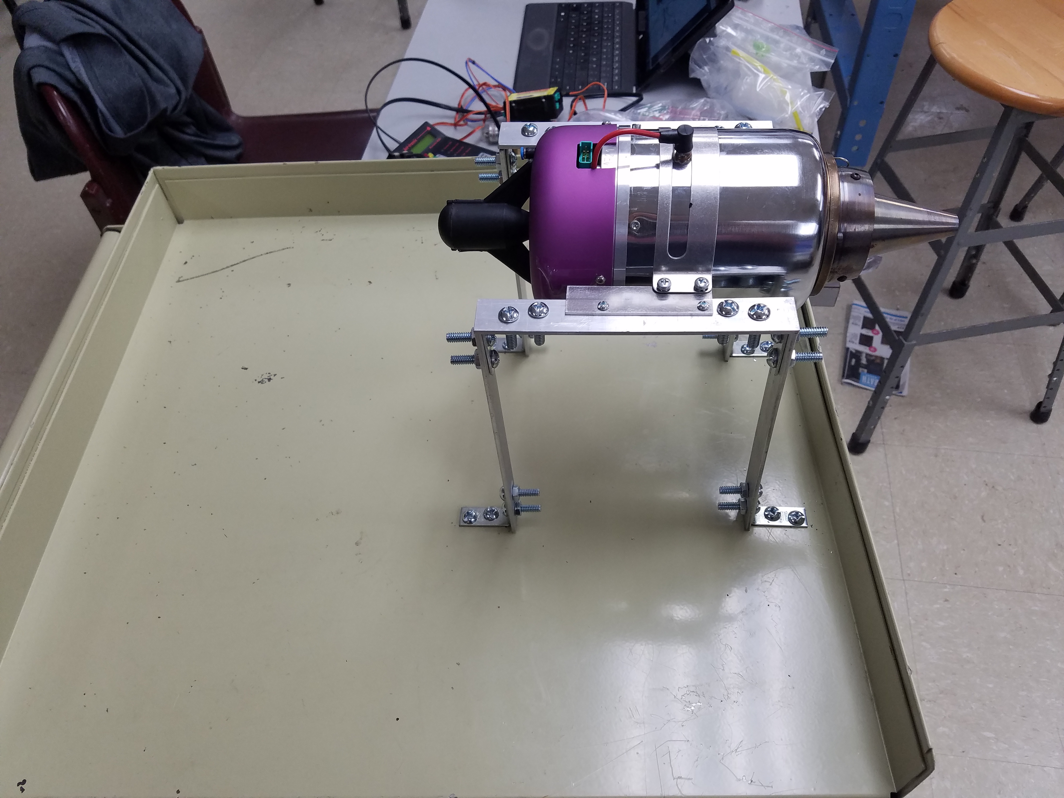

Hey guys. Just giving an update on my project. Got the engine mounted, but had a quick question: What would you recommend as receiver/throttle control? I think other than that, I have everything I need to wire electronics and fuel. I took John's advice on the Du-Bro 50 oz. tank (thank you for the recommendation!). Here's a picture of what I have so far. It's not much, but it's a start!
I might run a piece corner to corner on that bracket or either brace it diagonaily from the front corner to make sure it doesn't bend. You're the only one who knows how strong it really is, but without a triangle in the design you are relying solely on the stiffness of the metal to hold up the engine.

I made the mount out of 1/8'' x 1'' 6061T6 aluminum. I actually made it this way to allow for enough noticeable strain to be picked up by a strain gauge. I calculated the dimensions of the mount by using the maximum thrust of the engine (97N or 22LB) in order to get about 450 micro-strain. So there won't be near enough force to cause the mount to fail. Thanks for the idea though!
Hi Buckeye it interesting as your looking at it perhaps from an engineers point of view and I believe both Jester and I are simply looking at it from a practical point of view, Dude make it just like a set of seaplane floats, a simple "warren truss" with members working in tension from high at the exhaust end of the engine down to the torward low corner. That way you will be able to enjoy our engine at any power setting.
