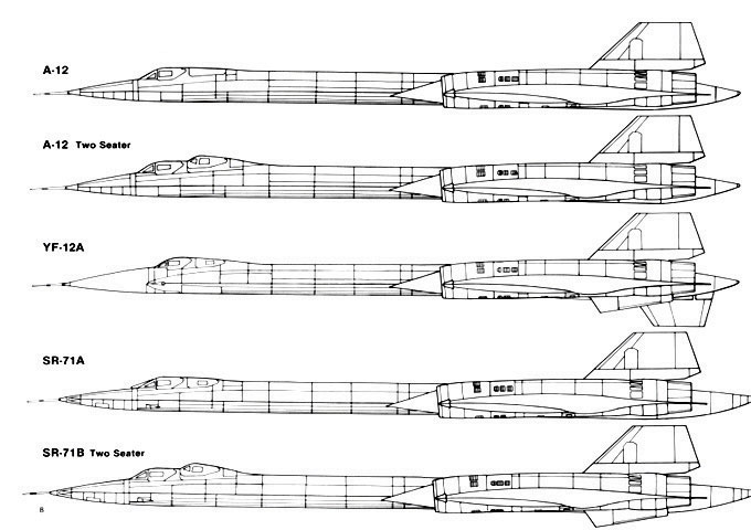

Name:	A-12 YF12A SR71 family.jpg
Old 02-10-2018 | 07:58 AM
flyboy2610's Avatar
Joined: May 2004
Posts: 743
Received 73 Likes on 51 Posts
From: Lincoln, NE
I think it's an A-12. The back end of the YF-12 is different, it has protrusions below the rudders, and the back of the fuselage is longer on an SR-71.
