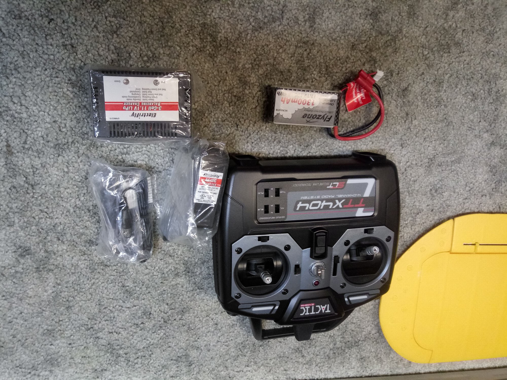

I have a Fly Zone Select Scale Super Cub...It is a RTF...has every thing needed...Makes a good learning plane and for tail drager learning...$175 + Shipping..Listed on RCU
Best you do some flying on simulator and have a Instructor pilot help you for as many flight as needed and make sure model is set up properly.....Jim
