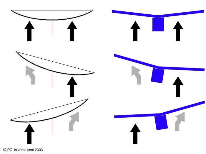

The Dihedral is for stability. Think about the kites you used to fly as a kid. There was always a string tied between the ends of the cross member to "bow" it toward the back. This, essentially, is dihedral If you look at the first pic below, you'll see how that bow on a kite works the same way that dihedral does, and vice versa.
When one side dips, the air can hit it more squarely, whereas it will deflect off of the other side. This creates a self-righting tendency.
By the same token, if you look at pic 2 you will see how dihedral will make it difficult to fly upside-down. Now, the self-righting tendency is not only gone, but you have the opposite effect. As one wing dips, it LOSES it's ability to catch air, while the other wing GAINS ability, so the wing wants to return to it's upright position.

"semi-symetrical" is actually a mis-nomer. Either you are symetrical (ie, 0 camber) or you have some camber. Some airfoils have a lot, some don't have much. As Minn said, most trainers use a fairly high lift airfoil with quite a bit of camber. They also tend to be set up such that increasing airspeed results in a change in pitch trim, ie ballooning, which also means it will try to automatically pull out of a dive.
Stability is more a function of dihedral as Minn said (for roll stability), and the relationships between the wing and the tail (incidences and areas mostly) (for pitch and yaw stability).
There are some very acrobatic and maneuverable planes out there with cambered airfoils, though most acrobatic planes have symetrical airfoils to make inverted flight easier, and allow them to do maneuvers inverted almost as well as upright. And you can make a very stable airplane with a symetrical airfoil as well. So the airfoil is only a small part of the story.

Airfoil - The only advantage of a symetrical airfoil is that it flys upside down with the same angle of attack as right side up. It is not quite as efficient as a cambered airfoil but is pretty well standard on aerobatic airplanes. The difference in flying characteristics between symetrical and cambered is not much. The "ballooning" tendency mentioned by MinnFlyer is more a function of cg position than airfoil shape. A forward cg is very stable in pitch and will pitch up sharply with speed increase, whereas a rearward cg is less stable and will not pitch up much (balloon).
Dihedral- Dihedral causes an airplane to roll away from a sideslip. If a wing drops due to a gust, or control input, the airplane will slip toward the low wing and if it has dihedral will roll back toward level. In aerobatic flight, in maneuvers that involve a sideslip, dihedral requires aileron input to prevent the roll. This is most apparent in knife edge flight where the plane is in a constant sideslip, and if it has dihedral effect it will try to roll out. This is sometimes referred to as "roll coupling".
