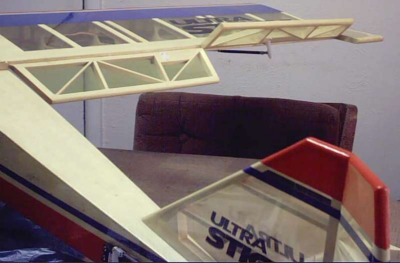

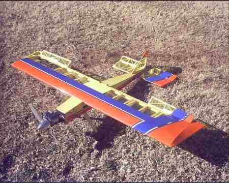

Ultra stick 60, Quad Flaps. All I have set up right now are the flaps. If I drop them, what will happen? Does it slow the plane down? Or will it climb?

I think the quad flaps use the alirons with the flaps so you can have all 4 up to do a very short takeoff, or all 4 down to do a floating "Crow" landing. Correct me if I'm wrong. I'm building (messing up) my first ARF currently. An Ultra Stick 40 with flaps. - Joe
