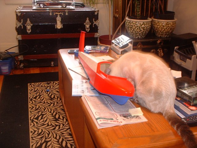

Thanks again to all for the replies, here & elsewhere. I'm not done yet, but I thought I would post(try at least) a couple of pics. I think one of our cats, Flash, wants a ridewhen its finished. She likes my Bell 222 also Hope I attached these correctly. I'll soon find out.
Joe
