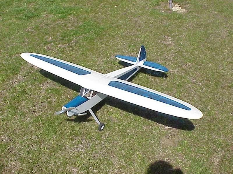

This is a rascal 40 arf with a saito 56 four stroke in it. The kit wasnt hard to build.
This plane was wrecked by me on its very first flight. I have repaired it sense.
Take caution on how light this plane is if you put a big engine on it. What happen
is i took off full throttle(the norm for me) and the engine litterly torgued this
plane right into the ground and damaging the wings. One of the other older
guys seen it happen and told me i had to much throttle on take off and he
was right. After repairs i only used about half throttle when i take off now and
all is well. Never had any plane do this to me before. I think the oliptical wing does
have a different feel compared to a standard trainer.
