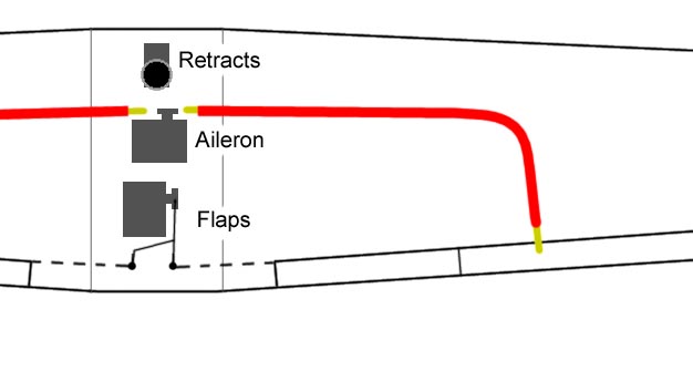

I have always enjoyed putting flaps on 40 size airplanes (all sizes for that matter)
With the current trend of using separate aileron servos, I have used Flapperons instead.
I will never do that again. IMHO, separate flaps are MUCH more effective, and if your plane is set up to use strip ailerons with torque rods to control them, setting up flaps is a breeze. Cut the aileron at a point that is about 1/3 of its length. Control the flaps with the aileron torque rods, and for the ailerons, either run flexible push rods from a center servo, or mount a servo in each wing.
Works like a dream.

What size is the RV-4? Normally for a small aircraft its not worth the effort for the amount of performance unless you are trying to go scale. Otherwise a 40 size aircraft can benefit from flaps, its not a necessity but a "neat" thing to have. There are advantages of flaps over flaperons. For instance, flaperons increase the angle of incidence over the entire span slowing the airplane but at the same time reducing the aileron effectiveness at the tips where is needed the most. While flaps only increase the incidence at the span section of the flap, leaving the wing tip incidence intact with plenty of aileron effectiveness. Problems with flaps? Its twice as much work as having just flaperons and more material and hardware making the aircraft heavier. Bottomline, its a personal choice.

ORIGINAL: B0ATLESS
Now, if I want to build without flaps (for now), should I use the full-length for aileron, or still split it and make the (future) flap area stationary?
What I would do is make them the entire length, add the torque rods (even if you're not using them for ailerons) and add an extra hinge or two so that when the time comes, you just need to remove a 1/16" gap from the strip, and you have two control surfaces ready to go.
