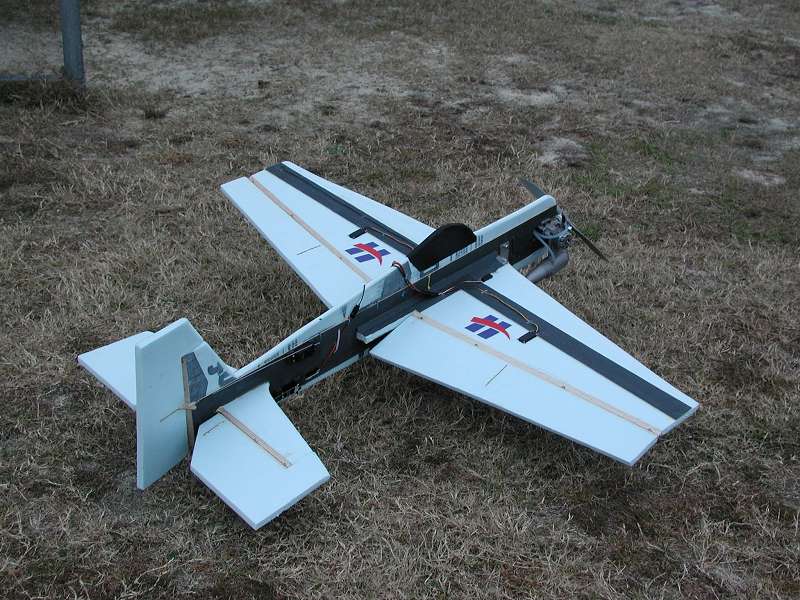

If you soak a brown paper bag in a glue/paste type of mix this will add a lot of weight. The simple solution is to insert one CF arrow shaft through the center of the wing at roughly 25% of the chord. I have seen this done on a handful of planes and the wings are still together with VERY VERY little weight added.

this is exactly where carbon fiber shines. it's lightweight, (like foam) yet very very strong (unlike foam) and it isn't unsightly like paper bags and glue, and doesn't look like a repair the way that fiberglass packing tape does. this is exactly what carbon fiber laminate is for. strengthening while adding as little weight as possible, and keepinga low profile. you should check outthe website anyway. you will find something that will be useful later on.
In the end, it's all good -- it'll work either way and as long as it's done neatly, the weight penalty will be small enough that you can live with it.
