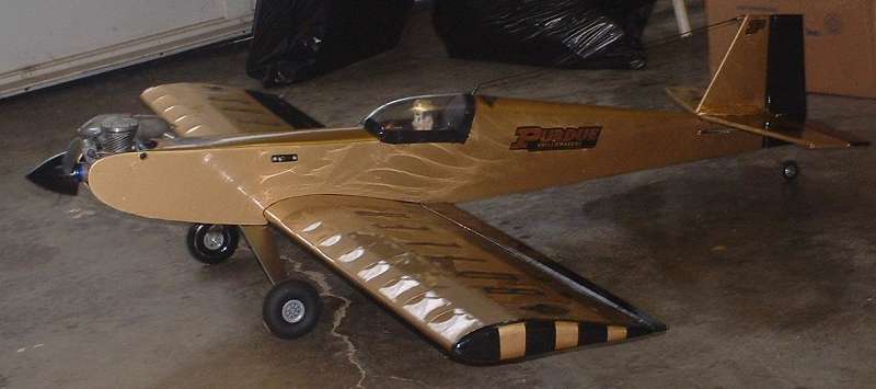

Hey,
I havn't been on RCU a lot lately because I have been working on my first kit. It is finally done. Here is a picture. You can see more pictures here [link=http://home.insightbb.com/~brownmattt/fourstar.htm]My four star[/link]
I appreciate all the advice and answered questions from you guys that made this possible!

Congratulations !!! Plane looks pretty good. Four-Star is a great flying airplane ( and All SIG`s are ). I see you even got a sponsor already, " Boiler Makers ". Good luck and remember to ask when in doubt.

Great job Wings. Your plane looks really good. I remember you said the wing broke off your trainer. Looks like your ready to go again. Are you going to maiden it.
Great job! Looks really nice!
I'm not familiar with the kit, are the wing saddles cut that nicely or was it a sand to fit. If it was a sand to fit my hats off to ya. Thats a toughy to get nice sometimes.

Thanks for the complements guys...
I think I am going to have an instructor maiden it. I was getting pretty decent at the Lt-40, but this is a low wing and I havn't flown in about 2 months now. Plus, the most important reason, I worked hard on it and don't want to crash it right off!
No sanding was required on the saddles.
I went to Purdue also, that bowl game was a heart breaker. Come back from that far and loose. Bummer.....

This is the only kit I've built and I have to say it was much easier than I imagined. Don't get me wrong, it was VERY time consuming, but it really wasn't hard. If you decide on the 4 star I can pass on a couple tips I got from other RCU users that helped.
The tip that saved me the most time was make sure you install the gas tank BEFORE you install the top part of the plane. The instructions say to do it the other way. It would have been next to impossible to get the tank in later.
Some one told me to drill small holes in the wing ribs to allow air to escape when covering. I did it and had no problem covering. Not sure what would have happend if i didn't.
The hardest part I had with the kit was installing the dowel in the front of the wing. It says to just drill it. Its really hard to do that because you are trying to drill between two thin pieces of balsa. If I had to do over I would have used a knife and cut a slot for it instead of drilling. I ended up screwing up the entire front of the wing. I ended up using scrap balsa to try and recontruct the part I gouged out. It wasn't pretty at all, but it is inside the wing so looks didn't really matter. I filled it, I mean completely filled it with epoxy glue. Then used wood filler on the front. I am a litte worried about it breaking off in flight. But with a half a tube of epoxy hopefully I will be alright.

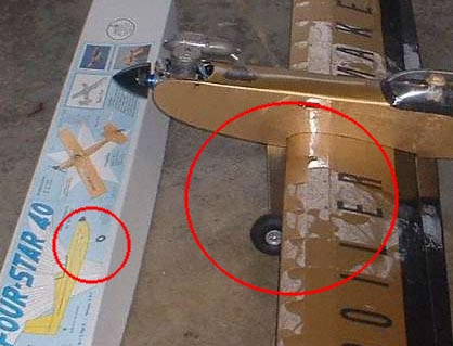

Sorry, didn't mean to be a jerk (It just comes naturally sometimes).
But seriously, I did think they were on backwards because I only looked at the large version of the first pic, and LG are usually raked forward. I couldn't see the TE of the gear in the pic, so it look like it was raked back, and when comparing it with the pic on the box, I just assumed you made a boo boo.

Ya, Minnflyer that is kinda weird how the box is different. I didn't notice that before. I thought you were just pulling my chain. I switched it around and it looks the same both ways. I guess as long as it rolls is the important thing right?

first, great job on the plane. i think it looks like a real flyer.
regarding the LG, it is on there right. just wondering if that is part of the kit or not because the gear is different than in the picture.
minnflyer, if you look into his "other pictures" the second picture from the end, you can see that the gear is symmetrical.
