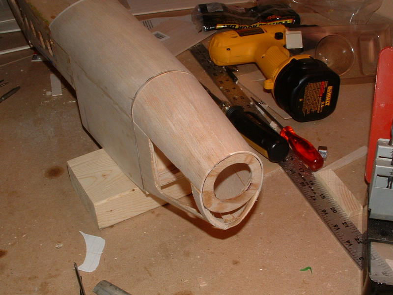

Hi all... Here's a thought.
I almost totalled my US+40, and rebuilt the engine cowl from balsa. I decided to paint it (LustreKote) to both match the black monokote, and to be fuel-proof.
For those interested, I first sanded, sanded, and sanded some more, then used white primer, then 4 light coats of black.
This is what it looks like... (note that the grain is still visible).
Maybe people can comment on how it could have been done better, but also, this will show what it looks like when done "just basic".
gus
At very little, if any, weight penalty the wood can be covered with light weight Japanese tissue before finishing.. This procedure covers the grain, absorbs less dope, and if a tissue color near the desired finalcolor is used reduces the required number of color dope needed. Color is heavier than clear.

Nice job Gus!
