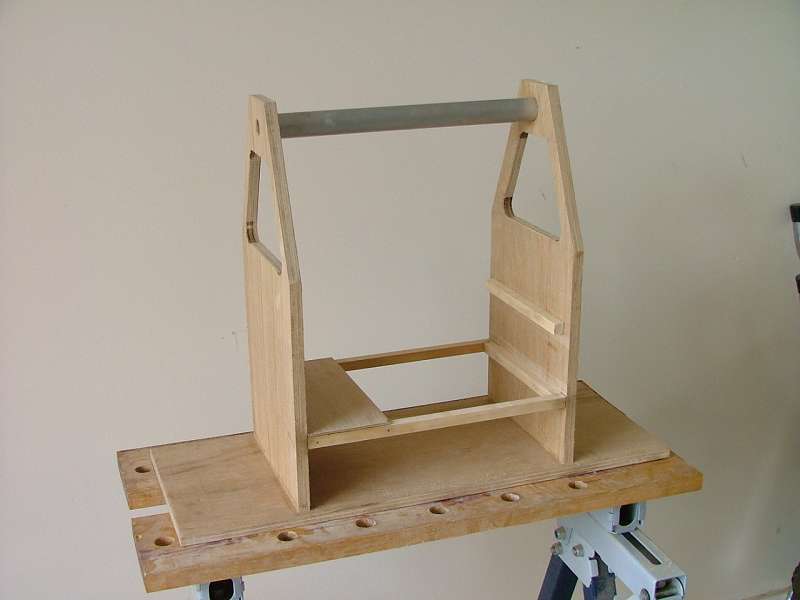

The pictures below show the basic structure around which the rest of the flight box would be built. Two 12mm plywood supports are glued and screwed to a 12mm base. A section of 25mm diameter aluminium tube is partially recessed into the supports to form the carry handle. You can also see the frame work which will support two sliding draws and a piece of 3mm ply which will be the base of a tall compartment. More to follow...

The rest of the centre frame work was easier to build on the bench before attaching it to the box. 6mm ply pieces are glued and nailed to 12mm square supports. With a bit of imagination you can see space for large and small drawers, a tall compartment and two short compartments separated by a divider. The short compartments are sized to fit an electric starter and the tall compartment will accommodate some tools, (screwdrivers, chicken stick etc) a spray bottle and the re-fueling hose.

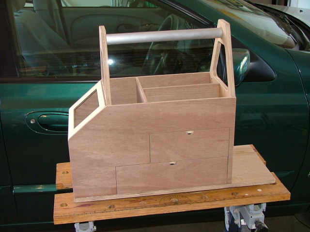

Now back to construction. The first picture below shows the 6mm side panels and 3mm end panel clamped into place to check the fit. the left hand compartment will house the battery and power panel and the right hand platform will support a 5 litre fuel container. After taking the photo, I shortened the battery/power panel compartment to a more practical size. It will comfortably fit an 18 Amp Hour 12 Volt SLA battery but I will be using a 7.2 Amp Hour battery - after all I'm only starting a 46 size trainer
The second photo shows the smaller of the two drawers. It is made from 6mm ply sides and a 3mm ply base. Pieces are glued and nailed together using standard white glue (no need to use expensive CA glue on a flight box) and 1mm diameter by 10mm long nails. I partially pre-drill the nail holes to prevent the wood from splitting and knock the nail heads below the surface of the wood with a centre punch. The drawer is really strong and will stand up to plenty of rough handling.

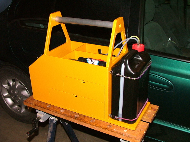

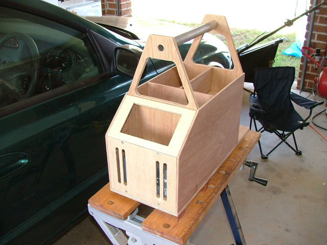

The flight box is now fully assembled and ready for paint. The battery compartment end panel has four ventilation slots and is held in place with self tapping screws to allows easy removal for access to the battery. The draws have semi-circular cutouts as opposed to knobs or handles for opening. This is simple yet effective, costs nothing, and there are no protrusions to catch on things and break off. Draws fit nice and snug but I will use either magnets or velcro (haven't decided yet) to hold them closed. So far it's not too heavy but 5 litres of fuel and a battery will put an end to that.

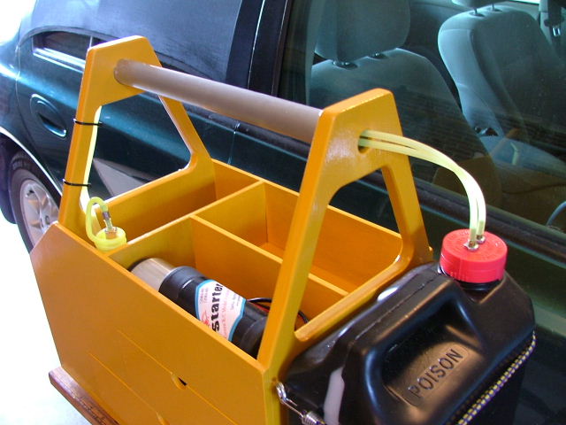

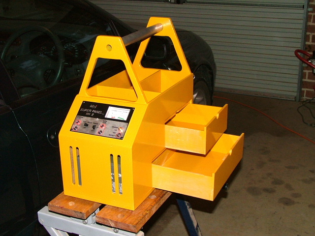

All painted up. I found that the drawers were binding initially as one shiny painted surface tended to stick to another. After the initial panic, and a few minutes deep in thought, I tried dusting a little talcum powder on the sides of the drawers. Now they slide nice and smooth again[8D]

Now that the flight box is built, It's time to start fitting accessories. Rubber feet are screwed to the bottom to keep the wood off wet ground and stop the box from sliding around in the car boot. Screw eyes are installed to allow the fuel container to be secured by mini bungee straps. I found the bungee straps in the camping section of my local department store. A good find!
I initially thought about making my own power panel (electronics is another hobby of mine). I soon discovered that just a few of the key components were going to cost more then a commercial unit so I abandoned the idea. Besides, who really needs a micro-controller equipped power panel with automatic menu based control and graphic LCD display?
. I settled on a MPI super panel because it has an automatic glow driver circuit (no need to adjust), glow starter charger, and the electric fuel pump connections are on the inside of the panel.

Now for the flight box fueling/defueling system.

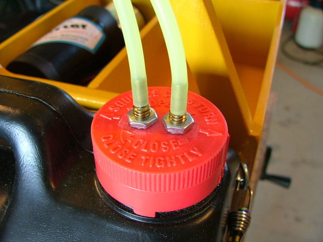

I made some adapters to fit the cap of my fuel bottle. 1/4" brass threaded rod is cut to size and a 3mm hole is drilled through the centre. A section of 3mm brass tube is pushed through the brass rod and soldered into place. Half-height nuts secure the adapters to the fuel cap and a 1mm piece of fuel hose is fitted between each nut and the fuel cap to provide an o-ring like seal. These are really easy to make and you only need a hack saw, drill and cigarette lighter style gas torch.

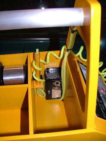

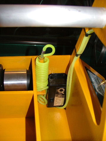

An electric fuel pump is installed into the tall compartment and the wires are fed through a small hole to the back of the power panel. Fuel lines are fed through the centre of the aluminium handle, via the fuel pump and to a piece of curly retractable fuel line. The return/vent line passes through the centre of a piece of dowel designed to neatly retain the fuel line. The bottom picture shows what it looks like when the curly line is extended during refueling.
