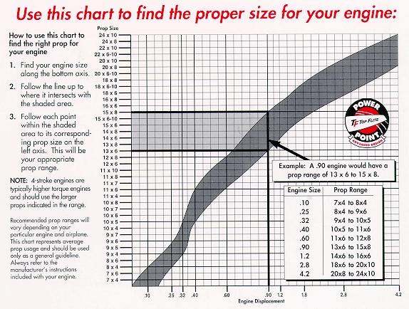

the manual is a good source of information,lot of fliers pick a prop them never change but if you'll experiment you'll probably find one you like the best.
I must admit, I do not know what thread it is on, or where it is located, but there is a table that you can print out. I will look and see if when I printed mine it kept the URL. Maybe someone else knows where it can be found. You might do a search here on ..prop table, prop graph..or something similar. And as mentioned, the engine has a manual with it and the prop recommendations.
That is a nice chart and should be very handy. One thing i didn't notice on the chart was the "prop factor" description.
prop factor = diameter times 2 and add the pitch...for instance a 12x6 prop ...12 times 2 =24 plus pitch of 6 = 30.
12x6 = 30 pf
13x4= 30pf
11x8 = 30pf
All props with the same prop factor take basically the same horsepower to turn the same rpm (there are slight differences between manufacturers). Witht the props ive mentioned if you want a speed demon use the 11x8 or if you want a stump puller use the 13x4 the motor wont know the difference.
If you use this formula and use a prop factor from the recommended props from the manual you should always be in the ball park.

Thank you guys,you have been very helpful.Nice chart dr-wogz, i am
gonna use it.Prop factor?Hmmm [X(] I am learning KENNYROY ,i am
learning.

"prop factor" is a good quick guestimate, but it does break down when you start moving more than 2-3" in diameter away. Also, I've seen a couple of different formulas, Kennyroy's being one of them, and plenty of people swear by their formula. It's an inexact science at best.
That chart posted looks pretty good, better than some that I've seen. Though I will say that I went and checked some engine/prop combinations I use, and I found them outside that chart's range. Not a big deal, of course, the chart is a good place for a start, and you won't blow your engine up with it. The chart also doesn't seem to show some prop sizes that you might encounter, such as the ones in the 12x4 range the 3D guys like to run.
Also, as I think someone else mentioned, differnet brands of prop in the same size will often pull very differently in the air. So sometimes you can change performace just by changing prop brands.
