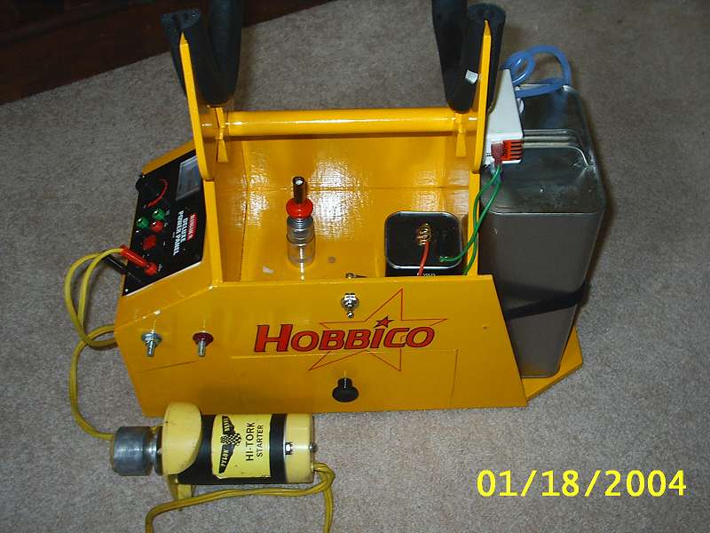

I wondered the same thing too but I went with the banana clips but it doesn't much matter I think it would stay in better if you pull it too hard here is a pic. be sure and put some posts on the side of your box so you can charge your 12 volt batt I used wife's nail polish to paint one red ( a real pretty candy apple red by revlon )

HEY! thanks guys. Does the 12v 7 amp battery run everything? The reason why I ask is because in gitterdun's picture it looks like he is running another battery to run his electric fuel pump, and are the posts on the side of your box plug-ins? Where did you get them at? thanks

No I used the 6 volt Batt. because I Found the 6 volt Pump At a swapmeet for $ 5 bucks otherwize I would have used the 12 volt it will have plenty of juice to do it all . I have a toggle switch for my pump on the side and The post are wired directly to my 12 volt batt. ther 1/4 20 bolts they stick out far enough to get your alligator clips on it from your batt. charger [sm=lol.gif]

hey gitterdun thats pretty cool! I think Ill put them posts on the side of my box too! You said you have a toggle switch for the pump on the side, doesnt the power panel have a switch for your pump too? Thanks

oh ya but all i had was the 6 volt pump when I fry that pump I will buy a 12 volt pump and then I can hook it up to the power pannel it also has the switch where you can reverse the pump its just makes more sense but like I said it was 5 bucks so you know !
