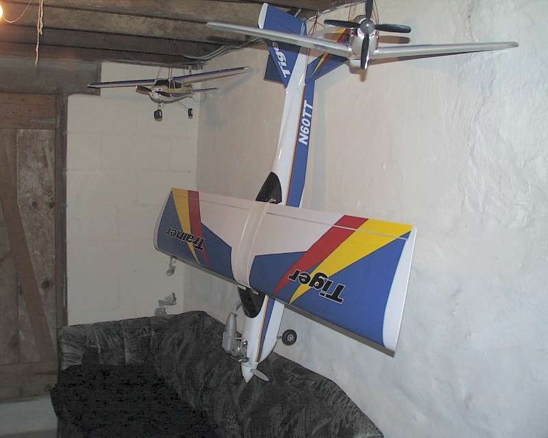

I was looking into changing the rubber bands to wing bolts on my TT60 trainer.
I'm trying to find the best way to mount them. I bought a couple of bolt kits from Tower.
These bands became a pain after awhile.
Maybe Minn could help with one his great illustrations
Thanks inadvanced
Here is the pic.

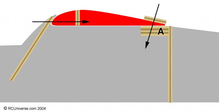

Ok, with that plane the conversion should be easy, because the windshield goes up over the front of the wing. But the first thing you must check, is that there is a PLYWOOD former in the fuse forward of the Leading Edge of the wing. If there is not, you will have to add one, and it must be deep enough into the fuse that it will lift the entire fuse (Including G-Forces). Next you will have to epoxy two plywood blocks (About 3/8" thick) to the fuse sides and the Fuse Former at the rear of the radio compartment (A). (Some square or tri balsa stock under these is a good idea too)
You will also want to remove a little covering from the center of the Trailing Edge and glue a piece of 1/8" plywood as wide as the Fuse to strengthen it for the bolts (So they won't pull through the wing during a loop!)
Now put the wing in place and rubberband it down so it won't move. And drill two 1/4" holes STRAIGHT through the windshield (and plywood fuse bulkhead)-into the LE- and through the wing joiner. Next, drill 2 holes through the trailing edge and block "A" (Your choice as to what size depending on if you want to use 1/4" nylon bolts, or steel bolts with blind nuts). If you're planning to use 1/4-20 Nylon bolts, drill these holes 13/64", then tap block "A" with 1/4-20 threads, and after the wing has been removed, re-drill the wing holes to 1/4".
You can then add two 1/4" dowels to the holes in the LE. Make sure they go all the way into the wing joiner. And if the wing insn't fiberglassed in the center section, It would be a good idea to do that (Lest the dowels pull through the LE)

Mike, Knight1...
If I may add - make sure those annoying torque rods, if any, don't interfere with Blocks "A". Been there. []

Very good point Vinnie. That's why 2 blocks are used instead of one long one across the whole fuse.

Wow... if you're spending a fourth of your time at the field working on rubber bands, there's something else wrong. Rubber bands are essentially string 'em & fling 'em. What on earth are you doing with them?
I've seen 3 planes converted to bolts from rubber band wing mounting - one Eagle II, and two AeroStars. All three had aileron torque rod interference after conversion, and had to be altered for that. Two of them, the wing popped off a few months later - in flight.
Thus, I recommend using a different plane, if you want a bolt-on-wing.

Rubber bands are there for a reason.
You should only switch to bolts if you feel confident enough in your abilities to risk ripping you plane to pieces.
Bolts do NOT shear! (And if they do, there won't be much left of your airplane)
Example. a 1/4-20 Nylon bolt has a 432lb shear strength (According to: http://www.plasticnutsandbolts.com/m...ltestdata.html).
What do you think will happen if you lay your airplane on its side and set a 432lb weight on it?

MinnFlyer has a NICE explaination except he left out one point... you usually need to reinforce the LE in the area of the dowels. This is especially true of .60 size ARF trainers getting this conversion!
A .60 size kit that has the option of either bolt-on or rubber band... the Great Planes PT-60. If doing rubber band mount the structure is the same at the center LE of the wing as your ARF. If doing the bolt-on wing, you have a loead bearing block that is 3/4 inch front to rear that fills from loweer sheeting to upper sheeting at the leading edge. This block is full width from the root rib to the next rib... it gets epoxied in place. The kit supplies a 1/8 aircraft ply plate and medium balsa for making that load bearing block.
