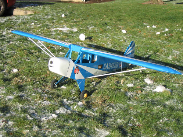

I'm building a clipped wing Piper cub 48 as second plane and I'm almost done[&:].
No need to say that moving from a trainner to a scale plane is definetely cool because you will try to make your best to make the scale plane looks like real, pay attention to details, so on. Besides, you will be able to answer the question you friends make to you "oh, you fly models, which plane you have?" with real answers other than "hummm, it's not a real plane, just a trainner"[&o].
It's fom Airborne models and was $140 shipped to my door.

3. Low wing - you will not progress as far with your second plane if you go with another high wing plane. I realize a Cub has already been mentioned but technically this is more of an aerobatic trainer. No doubt they are beautiful planes - I just picked one up second-hand not too long ago and I love to just sit and look at it. Not that it would be a bad choice if that is what you really want - you will just be delaying the low-wing advancement till your third plane.

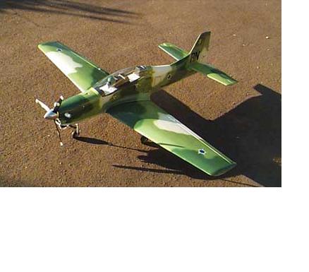

Yes, Piper cub is not a sport plane and I prefered to let the acrobatics for my third plane with a Tucano T27. That's gonna be all fun!
