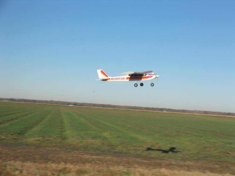

Hey guys after soloing on my avistar a while back the second to last flight I broke the wooden prop that came with my avistar. Now I put on a master airscrew prop of the right size. Ohk startup........... clicketyy clank clicketyc clan........... well it sounds like its way off balance.
order prop balencer.
Put it on balancer ....
Looks balanced. ok put it back on, same thing. Whats goin on? on the balancer both of the sides do not drop, rather just stay. The only thing i can think if is that the prop shaft hole in the prop was a little tight so i had to sort of "screw" it on. And when i got to the last part of screwing it on The whole shaft would turn so i couldn't put it on any farther. So I think maybe once i start the engince the prop wiggles in the space left that i couldn't tighten it into then it is sort of lose. Could this be it? what do yall think??? Thanks
