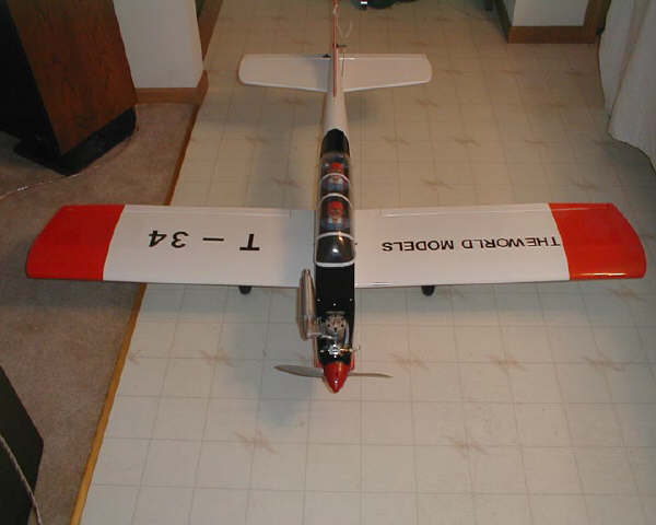

Hi i built the WM T-34 about 4 months ago and have approximately 40 flights on it. I used a New Rossi 40 and it moves!!!!! It was clocked at 102mph consistantly on level flight at the club field. I wouldnt recomend anything much bigger than that. My flying partner used a towers 46 but I can outrun him every time. Actually the wing is starting to stress in the wing saddles and developing a deep groove from the stress of the speed. I was really surprised at the speed ....almost as fast as my patriot. It is a very light plane and comes very well constructed and is a superb plane. I am purchaseing another one when this one meets its end and glass the wing area where it sits in the saddle. Very, very accrobatic. Since it is small it just isnt quite up to flying it at scale speed. But for fun you cant beat it !!!
PS. MVVS makes just about the same engine as the rossi 40 for about $130. I have 2 of them and will always buy the MVVS instead of the rossi's just because they are almost identical and cost 1/2 as much.

Skribnod,
Nice plane!
I don't have those 2 brands you mention available here, however if I get you right the the EVO 46 is more than enough to move this plane and won't need the extra power of the ST G51.
I might need to say that I actually hate the big & ugly muffler the STs have. So I guess I am moving now toward the EVO.
