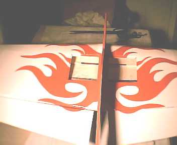

Below are some photos of the hatches I made for my Fat Free Taco and not my Superstar 40, but the concept is the same. Just make yours smaller to allow the placement of the battery.
**Note** Camera quality is very low. $20 Digital Camera from Wal-Mart until I get a better one.

DTB: Thank you for the pictures, I would think it should be pretty easy to contruct...

Well, i made a small hatch in the rear of my plane.. I orginally used my flat RX battery in the spot, but it ended up being to heavy, so i found an extra 4 cell sqare pack which is much smaller and lighter. After everything bolted together, I put it back on the CG machine and it ended up being slightly nose heavy which im going to keep till i get used to the plane. Up front the servos and reciever is in its stock location.
