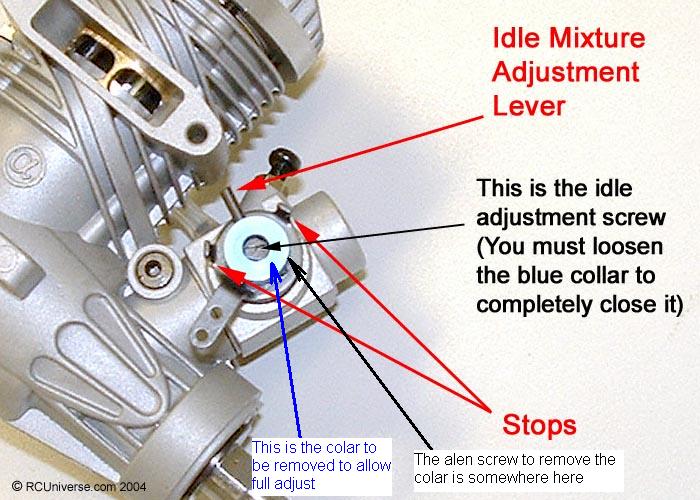

I have an Evolution .46 engine in my newly purchased trainer kit. The engine runs great at and above half throttle but will die at any rpm setting below half after a couple of seconds. My high and low speed needles have stops so that I can't turn either of them too far and I have set both of them at every possible combination of settings and still can not get this thing to idle. Can someone please tell me what I'm doing wrong?
First thing I would check is to make sure the carb is not closing off. Look in the intake make sure the barrel is not closed off when you retart the throttle below 1/2. The throttle linkage may need adjusting. If that's ok it sounds as though the idle mixture is too lean or to rich.....does the engine smoke alot and have fuel coming from the exhaust before it dies? if so to rich. If it suddenly quits to lean. Follw instructions from OEM to correct.

1) Firts set your throttle to idle and the trim to 50%. Then adjust the throttle linkage to make the carb barrel open 1mm = penny thikness.
2)With this on place remove the idle needle stops by removing an alen screw at the blue colar. You have to remove this blue colar. Inside it will be located the idle needle screw.
3)Turn the screw(needle) clockwise until you close the needle(don't put much strengh to avoid damage the needle)
4)Open the screw counter clockwise 1 1/5 turns ( about 360 + 70 degrees). This should be the correct position and the center of adjustment allowed by the stops later when you put it back.
5)Start the engine and try to see what happen. If the idle is bad, try to adjust the idle needle around the 1 1/5 turns to get a god idle, but not much far from it.Adjust the high speed needle as the max rpm and turn counter clockwise a bit with small decrease in rpm(rich side).
6)Let it idle and you may need to adjust the idle again.
7)You also can check the idle needle by the pinch test, that consist on pinching the fuel line when idle and the rpm should increase a bit. If it increases a lot, it is too rich. If it just dies, it is too lean. If is rich, close the idle needle(clockwise). If is too lean, open the needle(couter clockwise).
8)If all works good, put back the stop and let it be in the center of possible adjust.

I had problems helping some new guys at the club with these engines. Every one was fixed with a glow plug with a idle bar. None of the factory ones had them? Does yours?
Joined: Mar 2004
Posts: 7
From: Newport News, VA
Thanks for the advice and tips. After reading your suggestions, I did take the adjustment needles' stops completely off and got it to run perfectly. I was a little afraid at first in doing this with the manufacturer stressing the importance of not overleaning the engine.
