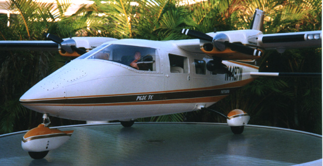

Most of my airplanes are painted with acrylic enamels, the Partenavia is painted with Synthetic enamels and has worked very well. And the Chipmunk has a coat of urethane clear to seal all that detail, the color coats are acrylic enamel (Dupont), very expensive.
