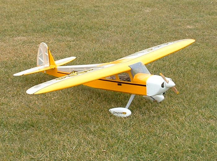

RE: How much power is enough
I recently reviewed a plane called a Dragon 40 (review not posted yet) in which I used an OS 52 4-stroke. This combination was perfect. The Dragon is a very light plane with an airfoil similar to a Cub (See pic).
On something like my Goldberg Cub, I prefer an OS 70, because the Cub is a bit heavier, and I like to wring it out a bit. Plus, I add floats to it and fly it off of the water. The extra power is really needed there.
If I were going to put it into anything that would be considered aerobatic (Extra, Edge, Cap, etc.) I would definately go with a 70 size 4-stroke.
