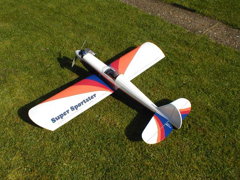

Old 06-06-2004 | 03:48 PM
Joined: Jul 2003
Posts: 648
From: UK
Default RE: second plane choice comes down to this..
Good Choice photoniq, this was my 2nd plane and im now into my 20's in planes lol, but i still love to fly the Super Sportster (actually flew it today and everyone says how well it flys ) and its stood up well for the amout of flights ive had with it althou the landing gear does need bending slightly forward
Good Luck

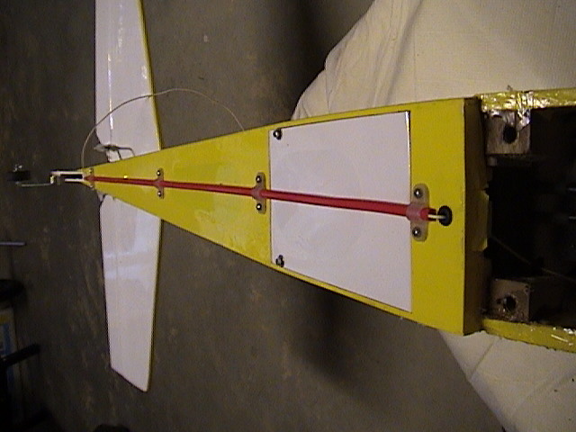

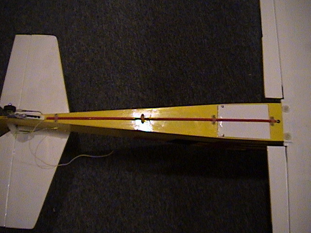

photoniq:
You stated you had to add a ton of lead to the tail; consider what I did with my 4*40 (see attached pics) as a way to balance without additional weight. I installed an access panel in the bottom of the fuse behind the wing and placed my battery amidst wads of foam in the rear of the aircraft. This might necessitate adding additional support struts inside the fuse, but mine worked out great! Battery not heavy enough? Move it further back, or go with a 2000 mah nicad for additonal weight AND flying time! Enjoy!
ID:	140368   Click image for larger version
Old 06-07-2004 | 04:46 AM
photoniq's Avatar
Joined: Jun 2003
Posts: 463
From: London, UNITED KINGDOM
TNrabbit - I though of doing that but i'm not a very good builder and just wanted to fly the plane. I guess I might do the mod one day in the future but for now i'm happy with the plane the way it is. Thanks for the tip,
