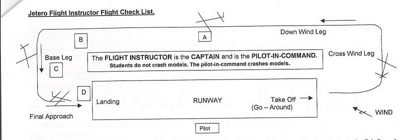

CROSS WIND: 1. Fly out as desired for at least 100 feet. DO NOT allow student to make more than 100° of turn. Make him/her make definite turns to a heading to increase the discipline of positive aircraft control.
2. Normally the student will reduce power to a "Cruise" setting on the Cross Wind. Teach Power Control from Flight One. Watch for student failing to keep thumb/finger on Throttle Stick. Impress upon student that learning to fly will require attention to both sticks. Learn it now. Start Cross-wind correcting.
DOWNWIND: 1. Teach the Student the importance of maintaining a TRACK parallel to the runway. Demonstrate and require him/her to be aware of wind drift and correcting heading into the wind to track the desired parallel of the runway.
2. Emphasize the maintaining of altitude. It takes focus on this point when starting to slow as additional elevator pressure must be maintained to allow the aircraft to slow.
3. POINT A abeam the pilot is where the student should begin slowing the model.
4. POINT B Pilot starts turn (90 to 100°) toward runway's extended centerline. Begin descent and call "LANDING". Power control as needed to control descent. Here the student should start learning that power controls altitude and elevator controls pitch attitude and/or Airspeed.
PRIOR TO ATTEMPTING LANDINGS, PERFORM SLOW FLIGHT AND GO-AROUNDS DESCRIBED BELOW.
BASE: 1. Determine flight path to runway via a turn that lines the airplane with the extended centerline of the runway. Establish an imaginary mind-picture of the descent profile and the flight path to cross over the runway's end at about 10 feet in the air. Establish an airspeed much slower than cruise, but adequate to maintain positive aircraft control.
2. Maintain the airspeed primarily by maintaining the desired pitch attitude and assist with throttle. If model is high, reduce throttle for a second and then reapply. DO NOT WAIT to see adjusted flight path. It is better to make several small adjustments rather than one too big. If model is LOW, ADD POWER FIRST BEFORE ANY OTHER ITEM, Level wings then continue. Reduce throttle and then readjust the flight path as needed. When sinking low or even when it appears that model will sink, add power, then pull back It is far better to go around than to land short, especially in an uncontrolled landing.
3. The final turn is a change of relationship and can be confusing for the novice. The airplane changes sides in view point. However if onecan see the side of the airplane after the turn, one will not be flying towards the runway, as the flight path will carry the machine too far out. During the turn, the student should add some power and immediately reduce it upon completion of the turn. The exception being if far too high, in which case a go-around may well be the best course of action. Complete the final turn looking directly at the nose of the model.
FINAL APPROACH: 1. Plan a direct line from the completion of final turn to runway center and about 50 feet down the runway, both vertical and horizontal. In the vertical this is just over a 10° glide slope, 10'+/- over the end of the runway. This will allow a slow deviation from looking eye to eye at the model to a more side view, yet still allow for wind drift and correcting to over the center of the runway.
2. Correct all deviations from glide path with short bursts of added power or reductions as needed. Depending upon speed of the model after the final turn, the altitude, etc. most trainers will be ready for idle at or shortly after completion of the final turn.
3. The final approach correction for cross wind will be a larger number of degrees than on downwind due to the decrease in speed. Watch the TRACK of the airplane and maintain heading to keep the TRACK down the center. Generally the wind effect will decrease in the last several feet above the ground.
4. During the slowing and round-out phases of landing the angle of descent will decrease, thus requiring elevator control pressure to be maintained and slowly increased to keep the nose from dropping. ONE CANNOT RELEASE THE BACK-ELEVATOR-PRESSURE WHEN USING THE AILERONS WHILE ROUNDING OUT. One must fly both items while landing. In those cases of efficient flying the pilot can well use the rudder to replace aileron, stabilize the aircraft, assist the ailerons, or a combination of all. Rudder is a very effective tool to prevent the feared Tip-Stall. On the ground, the student should learn to quickly transition back to the rudder for steering and holding the pre-explained taxi controls with the aileron/elevator control stick.
