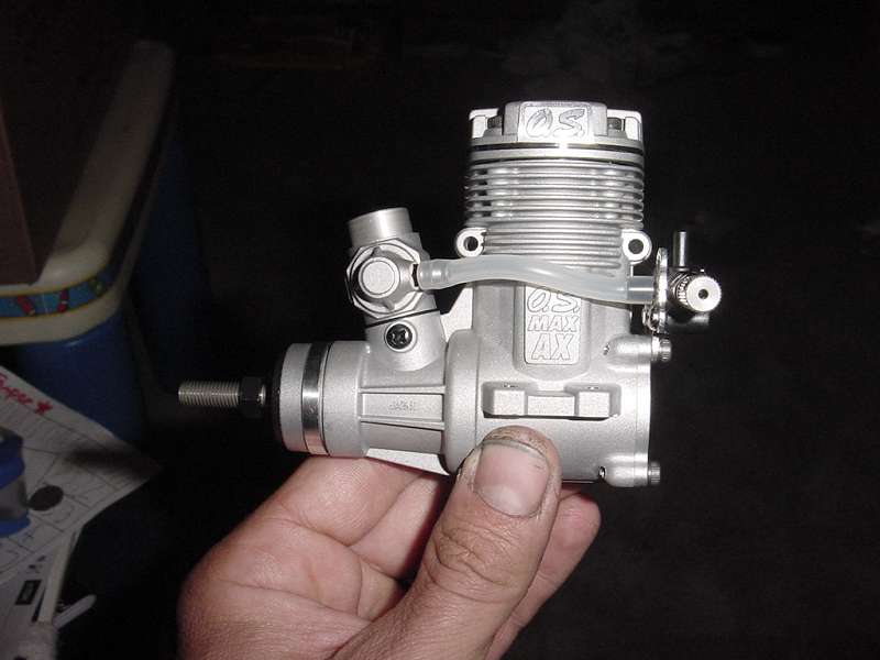

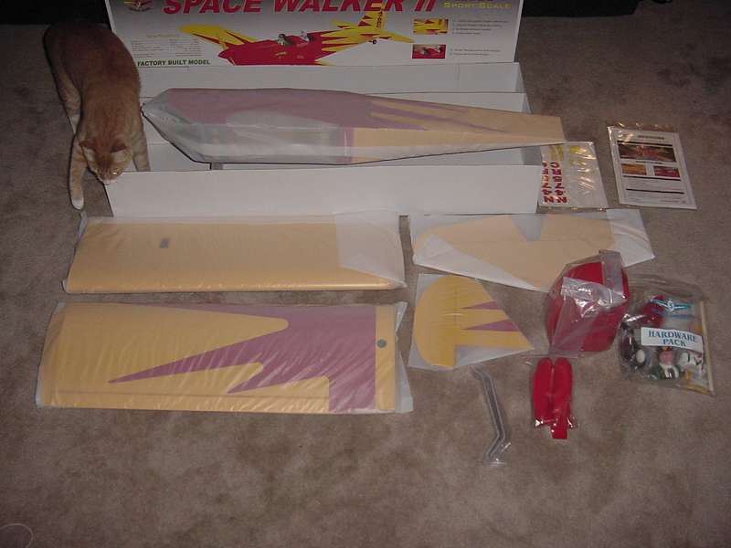

I got the bug for a taildragger, and I have an LA 40 sitting around doing nothing, so I figured I'd hike down to the LHS and pick up a Skyraider Mach II. Nice cheap plane, I've got another receiver and servos, everything I need. Nice and cheap.
Well.
LHS out of stock on Skyraider Mach II. Figures.
So I pulled a Super Flying Models Eindecker off the shelf and had a look at it. Nice plane, suits my style of flying, will fly with LA 40.
What I really want is a Rascal, but I'm not putting a 2 stroke on one.... just wouldn't seem right.
Remember, I went in with the intention of getting something cheap that I could fly with what I had lying around already.
Then Dean comes out of the store room with a smile on his face.
"I got something you'll like here" he sez.
<sigh>
But it sure is pretty! Put together nice, too. So what if I need to get another servo. Sure the LA 40 will fly it, but I got to looking at the size of the fuse and the size of the cowl, and the size of the LA compared to the airplane..... no way. Of course the first engine Dean pulls down is a Saito 56, but that's a tad bit over budget. But it IS what the plane needs........ so I compromised. And since it's just Sooooo nice, I had to get some other extras, a voltwatch, gold-n-rods instead of factory pushrods, some small scale details, all the good stuff. I'll post some more assembly pics as I progress....

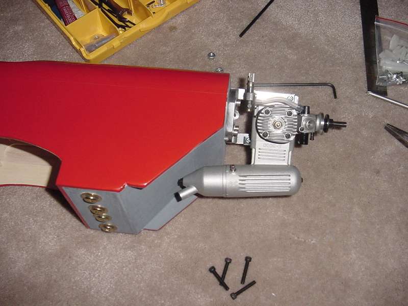

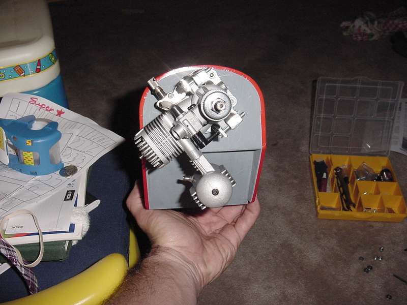

They haven't steered me wrong with an airplane yet, and every time I walk in with a question, one of the guys has the answers. BTW, for a plug, it's Debbie's R/C world in VA Beach, if you're in town, I highly recommend a visit!
They're calling for 5 5/8" distance from firewall to back of thrust washer, best I can do with AX is 4 1/2 inches. Will have to see how it sits in the "cow".
I didn't really like the way the stock pushrods were done, and I wanted to try gold-n-rods, so this was a perfect opportunity. I also opted for WM adjustable clevises, I liked the way they worked on my SS 40. I want to use a throttle cable, but will require remounting cable sleeve. Might do that anyway as it sits below the fuel tank, and will require a major bend in the throttle pushrod anyway. Trashing stock tank, too small and I don't care for the nylon tubes. I salvaged the tank from my Avistar, and that, with a new sullivan stopper, is going in. A little larger, and fits a little looser so I can get some foam around it.
but all in all I'm really impressed with the overall quality of the building. I did run some epoxy around the firewall, landing gear and wing mounts, and the formers that support the landing gear. I'll get the thin CA out tonight and go over as many other joints as I can get to, then it's on to fuel proofing the tank compt. I see the firewall is painted with some sort of gray paint, but I just varnished over that, didn't know if it was fuel proof or not and don't want ot find out the hard way!
Landing gear is held on with metal bolts, replacing with nylon.
Wish they had included some edging around the cockpits, it was a simple cheap fix and it looks a whole lot better in my opinion.

My engine mount looks pretty straight. Main problem I have I can't get the 5 5/8" called for in the manual. Oh well, I'll just do the best I can.
I was originally going to try and get an airplane that I could fly with the LA 40, but it just looked sooo small on the front of that fat fuselage...
I've got some more pics in camera that I need to download... I hate to steal Minn's thunder, but I suppose I should just submit a review once I get it flying....
