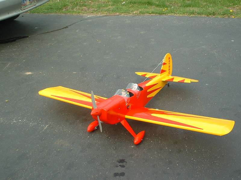

I just about have my spacewalker done. Just have to attach the pieces to the sides of the landing gear and screw down the pilots. I have a question about the wheel pants on this plane. As you guys that have this know, the instruction manual is very poor. [:@] The section for the wheel pants gives the following instructions: Attach the wheel pants and landing gear, following the following pictures.
I have done everything short of getting out a magnifying glass to see if I have done it like the book shows. According to the pictures, the wheel pants are held in place on one side by washers and nuts (so it is sandwiched between the gear and the nut and washer), and on the other side by wheel collars. This leaves the wheel to "float" between the wheel collar on one side and the nut on the other, which gives it quite a bit of side to side area. Is this correct? Anyone else concerned about this, and if so, how did you "fix" it? I have thought about putting some extra wheel collars on it to keep the play on the wheel to a more normal.
I know that this is an "inexpensive, Vietnamese" ARF, but how much does it cost extra to have someone that speaks the language proof read it?
I have done everything short of getting out a magnifying glass to see if I have done it like the book shows. According to the pictures, the wheel pants are held in place on one side by washers and nuts (so it is sandwiched between the gear and the nut and washer), and on the other side by wheel collars. This leaves the wheel to "float" between the wheel collar on one side and the nut on the other, which gives it quite a bit of side to side area. Is this correct? Anyone else concerned about this, and if so, how did you "fix" it? I have thought about putting some extra wheel collars on it to keep the play on the wheel to a more normal.I know that this is an "inexpensive, Vietnamese" ARF, but how much does it cost extra to have someone that speaks the language proof read it?

I haven't figured out wheel pants either. There's enough room to make small hardwood block inside, and use one wood screw thru landing gear legs to hold them. Might be more secure that way. Gonna have to make some sort of spacer inside, because if you just clamp the wheel pants between the strut and the hardware, it will flatten and probablly crack it. I was just gonna fly without them for now... might even put larger wheels on it, just for S&G.

nebbie I set my wheel pants up the same as the great planes do for the ucando46 they work great if you can find a manual,they use two light pieces of plywood and drill a 1/2 hole in the pant and wood to except the nut from the wheel axle. and then two screws for eather pant Andy has the right idea....... I have to run right now! wifes yelling...... the way they set them up will only just cause you grief or move in the air and make for a tuff landing it happened to me with my extra 300s seagull ..........I cant fly with my pants off
.............. HEY i found it ....... try this link its the manual for the ucando page 13 wheel pants http://www.greatplanes.com/manuals/gpma1269-manual.pdf

Thanks for the advice.
Just a quick note. My wife actually looked in the side of the garage that is my workshop this morning. I have the Spacewalker sitting on the table in the middle of the garage. She says that she like the people in it, and then asked if my other planes have people in them. As my other planes are a Superstar trainer and a Ultra Sport 40, there wasn't any pilots in them. I guess in the future I will have to look at putting pilots in them, at least for her enjoyment. The pilots come with the Spacewalker, but without any instructions on how to secure them. Right now I just have them tacked in with thick CA. I am going to put a couple screws through the bottom this weekend, before I maiden it. Pilots are not any good if they decide to abandon ship during flight
EDIT: After reading the manual linked above, it is easy to see the difference between that manual and the one for the Spacewalker.

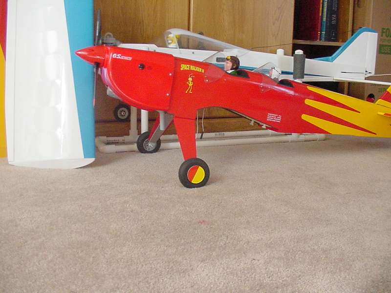

I installed pilots in spacewalker with screws.... they're not going anywhere. Should get maiden flight tomorrow. I put wheels off avistar on it and am going to leave wheel pants off for now.

I took the wheel paints off and put bigger (rubber) wheels after about 10 flights. Takes off 100 times better now. The wheel pants are pretty, but a pain in the butt! Can't taxy through grass, the wheels are too small and the pants hang up.

I used 3 ". They work niceley. I used socket head allen bolts for the axles. I tried regualr bolts at first but they kept bending. All though if I had to do over I would get 3 1/2". The 3's sometimes get stuck in the grass at the field when it's not freshly mowed. Then I have to carry the plane to the run way.

OK, after flying it today, that caps it. The wheel pants are staying off, I llike the way it looks with the hubcaps. After a couple false starts first thing this am, including one of teh wheels coming off on takeoff, I finally sort of kind of got the hang of this taildragger takeoff downpat. Then up comes the crosswind.
Oh well. Good thing I got a lot of cub yellow trim tape..... the wingtips are taking a beating.
