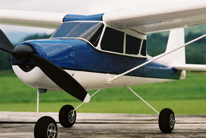

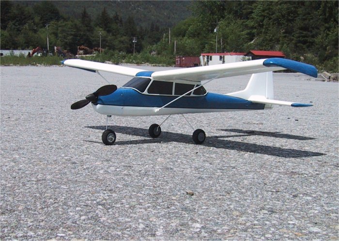

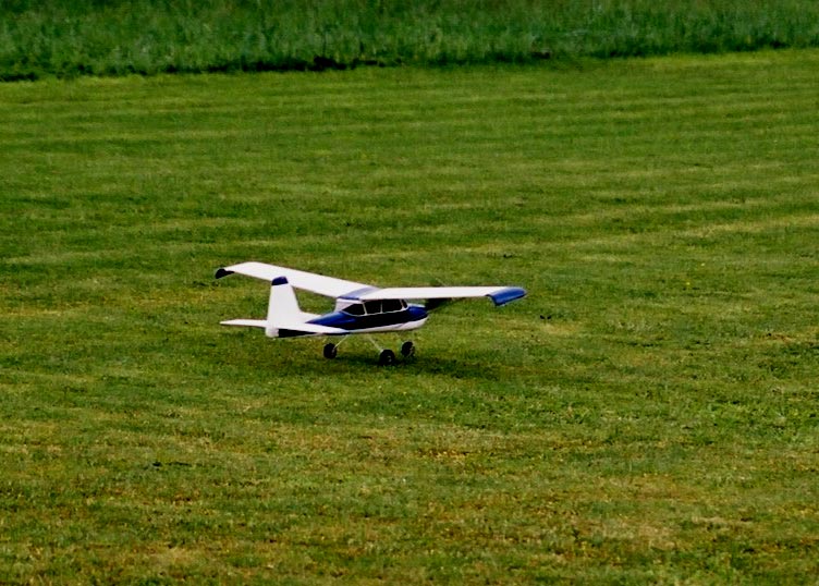

Here's mine I just maiden her last weekend...
Stock GWS 350 C Gear
8 Cells 8.4 Volt 750 Mah Pack
9X7 GWS Prop
She's a little slow to take off, it would be better with a 10X8, but I don't have the clearance with the trike gear...
Very happy with the in-flight performance !!!
Sam

Did you do a custom on your trike landing gear (I've never seen this in the factory kits)? Is the front wheel actuated by the rudder pushrod, or just show? I've flown a few Estarters, but your's by far looks the sweetest. Do you have any closer pics of the landing gear details? Thanks.

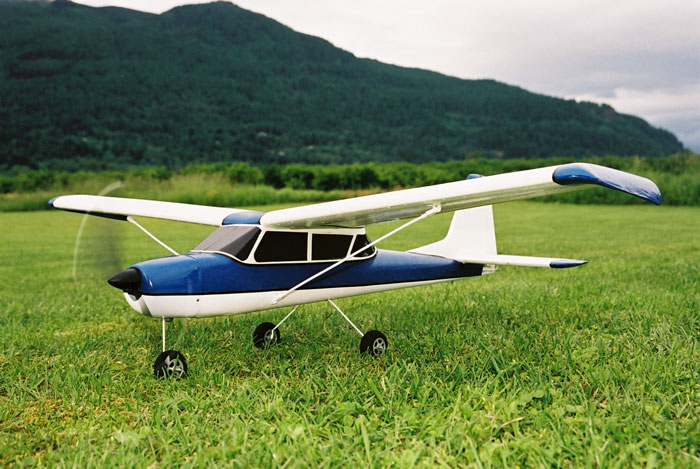

I did the nose gear mod with Du-Bro 1/2 nose gear, it works by the way of a push rod from the rudder servo...works awesome...turns in a nice 5' to 6' circle...
Here's a couple more pictures:
