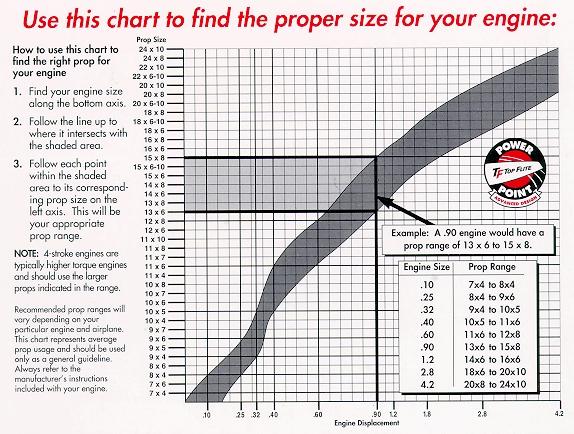

Copy and paste to your pictures, then print this out, and put it in your shop!
that's weird. I have a seperate post running asking what prop I should use on my OS 46fx in a super sportster 40. I have been advised to use a 10x6 both here and at another forum. This does not fit with the chart above though...

If you look carefully at the chart you can see the 10x6 is barely out of the suggested range on the low side. IMHO the 10x6 is a little small for the FX. An 11x6 will work better for sport flying unless you live way above sea level and your engine is starving for power. I have a 10x7 on my FX with a tuned pipe and I'm turning 15,300 on a hot humid day, my little aresti will haul butt, but the engine life will be shorter. Just my $.02
