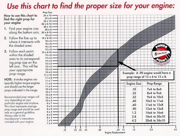

Default RE: Picking a Prop
Looky here!!!!

Jett's chart pretty much spells out prop selection. You just need to remember this simple factoid. Pitch=speed, diameter=power. Pitch makes the plane go faster. Diameter (or length of prop) gives you more pulling power. You want a low pitch long prop for what you are asking for. Also to go up and down in prop sizes. You trade 1 for 1. In other words a 10-6, 11-5, 12-4 and so on would have about the same load on your engine. You can go the other way too 10-6, 9-7, 8-8. This is aproximate and is a good guide for experimenting.
