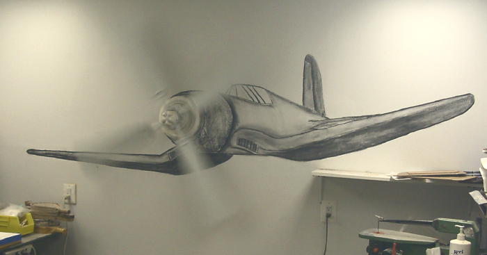

You NEED a wall like this!

Jim,
Is that a ceiling fan powering that Corsair??
Dennis-

Yes it sure is. A 120 volt electric!

a ciling fan on the wall!? hmm thats interesting!, now put one on the ciling goin strait down with a ciling fan on that!
how good does that fan pull the corsair? and how many batteries do u run in it?
