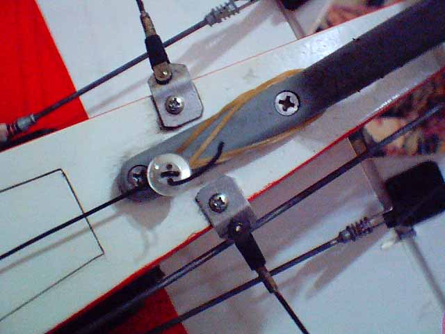

Use a button on both ends of the antenna and use a rubber band to secure it to the tail, see photo.
Cheers.
