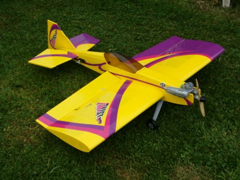

I need to pick everyone's brain a little bit.
I am having a slight problem on takeoff regarding both my tail draggers.
I can keep the takeoff roll nice and straight using rudder, but once the main gear leaves the ground and I get about 5 feet in the air the plane starts banking left. Longitudinal balance is right on and CG is where it is supposed to be. Trim is perfect in flight with no banking tendencies.
Ground handling is fine and both planes track straight on high speed taxi runs.
I tried keeping the plane on the ground until I get more airspeed but it did not help. I tried both keeping the tail planted on the ground until I had enough airspeed to fly and also let the tail rise when it was ready. I am positive it is torque, but I could be wrong
I am looking for suggestions. It is not uncontrollable but it does bother me. [>:]

You are probably tip stalling because you are climbing out at too steep an angle, (at least that is what I found) - it will gather speed more quickly the air than on the ground.

Give it a little right rudder on climb out.

I think right rudder is the answer too. I intitially suspected that you were near stall speed, but after further reading, don't think that's it. Most of my planes require some right rudder (and or aileron) at lower airspeeds to keep it from rolling slightly to the left. And yes, chances are it's torque.

Thanks everyone, please keep the suggestions coming.
It usuall yakes right aileron to get it back. I am pretty sure I'm keeping the rudder input in but was not on the ailerons until it would start it's bank. I'll give the aileron suggestion a try along with a touch of right rudder.
Do you all think that if I add more riht thrust that might help to help compensate for it
Again, it's not severe, but annoying as I can usually take off straight and fly out straight with a Tri-Gear without an issue on a trainer.

I wouldn't add any more right thrust until you've flown them for a while. You'll probably find the right combination of inputs and get use to the take off routine. Adding right thrust may impact the flight characteristics, which you said were fine.

Thanks Dennis
The right thrust was just a thought. Yea, in the air they are both beautiful flying planes

yo bubba, what prop you swinging on that Twist and how long you been flying it?

And are those ailerons on the Twist in neutral position in that photo? They appear to be way high for neutral....that may be part of the problem...kinda "air-braking" it on takeoff???

I just maidened it tonight and did 4 flights. Dang thing is a ball in the air. Once I get the 12.25X3.75 APC prop on it, it should really be a blast but I want to get better on the takeoffs first since the larger prop will add more torque. The current prop is an 11X5 APC
The 4* has about 10 flights with a 11X7 prop (started with an 11X5 APC also) which will also get the 12.25X3.75 APC prop eventually but am waiting for the same reasons as I mentioned above for the Twist
The surfaces are not neutral in the photo. They are when radio/servo power is applied. The plane took absolutely no aileron/rudder trim but needed 4 clicks down at about 3/4 throttle on the elevator
